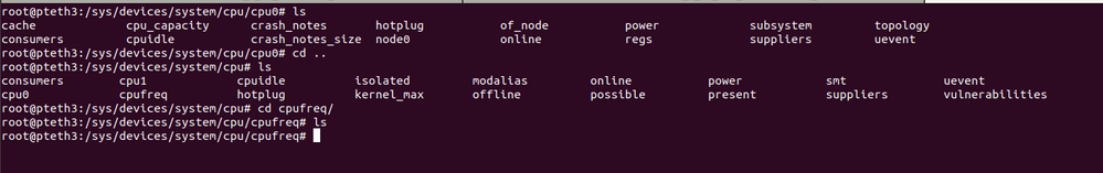

       1) Our custom board we are using imx8m mini dual core industrial processor (1.6 MHZ) we have used same imx8m mini evk sdk but evk contains quad core consumer processor (1.8 MHZ) any thing we need to change in uboot and kernel code ?
      2) /sys/devices/system/cpu/cpu0/cpufreq# cat scaling_available_frequencies if we see in imx8m mini evk board we can able to see cpu frequency same sdk code used for our custom board if we see in same location /sys/devices/system/cpu/cpu0/  cpufreq location does not present.
         Linux menuconfig cpu frequency scaling was enabled
         Why we are unable to see cpufreq folder ?
      3) imx8m mini evk board spi sensor communication we can able to read 13600 data per second (spi baudrate - 1.3MHZ)  device tree spi max freq - 9MHZ
         Our custom board same code able to only 7000 data per second.
         Custom custom board if we increase spi speed to (6 MHZ) we have some how read 13000 data.
         Why we are getting this issue on our custom board ?
         Evk contains quad core processor and our board dual core processor due to less core we are getting this issue ?
         Cpu frequency may causes this issue ?
         Please help us to solve the issues.

BiyongSUN
What's pmic you are using for the customer board?
If the BSP pmic settings doesn't match the hardware, it causes dvfs doesn't work.
For example, L5.4.24-2.1.0 BSP default supports ROHM BD71847MWV.
And L5.4.70-2.3.0   BSP default supports PCA9450.
The i.MX8MM evk board is mounted  ROHM BD71847MWV. If you use  L5.4.70-2.3.0.
The dvfs will not work. Because  L5.4.70-2.3.0   BSP  try to find PCA9450. But hardware is ROHM BD71847MWV.
You can check if you have "Can't find PMIC" message.
U-Boot SPL 2020.04-5.4.70-2.3.0+ge42dee801e (Dec 04 2020 - 00:28:49 +0000)
Can't find PMIC:PCA9450
DDRINFO: start DRAM init
DDRINFO: DRAM rate 3000MTS
DDRINFO:ddrphy calibration done
DDRINFO: ddrmix config done
Normal Boot
root@imx8mmevk:~# ls /sys/devices/system/cpu/cpu0/cpufreq
ls: cannot access '/sys/devices/system/cpu/cpu0/cpufreq': No such file or directory
root@imx8mmevk:~#

igorpadykov
Hi Vasu
for industrial processor (1.6 MHZ) one can consider a53_opp_table "operating-points":
https://source.codeaurora.org/external/imx/linux-imx/tree/arch/arm64/boot/dts/freescale/imx8mm.dtsi?...
for "dual core" - "maxcpus" kernel boot parameter
https://www.kernel.org/doc/html/v4.14/admin-guide/kernel-parameters.html
igor

igorpadykov
one can recheck linux kernel configuration using sect.2.5.3.4 Menu Configuration Options
Linux Manual included in  Documentation
igor

 Thanks & Regards,
         Vasu

BiyongSUN
root@imx8mmevk:~#

Dhevan
Hi @BiyongSUN,
         Thanks for your reply,
         Our custom board we are using pmic pca9450.
         pmic ic - PCA9450_HVQFN56P_A
         Please review attached pmic configuration

PStoykov
Hi @Dhevan
Did you manage to get the cpufreq running on the imx8m mini?
I also have an empty "/sys/devices/system/cpu/cpufreq" directory. And the cpufreq directory in cpu/cpu* directories doesn't even exist.
