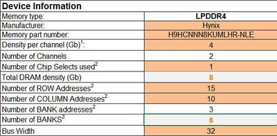

I use Newest MX8DualX_C0_B0_LPDDR4_RPA_1.2GHz_v15.xlsx to DDR Stress Test。I set the corresponding parameters of LPDDR4 and used the MX8_DDR_Tester.exe tool to test.The test result is not what I want.
I set 1GB(8Gb) in MX8DualX_C0_B0_LPDDR4_RPA_1.2GHz_v15.xlsx,then use the Stress Test Script CBT to test ,I found the MX8_DDR_Tester.exe log Display only 512MB。
How can I get the correct log, can you give me some help?

for H9HCNNN8KUMLHR part settings may be as below

I mean, the DRAM used is 1GB, and there is only one die ?

if I want use 1GB DRAM,In imx8dx,the LPDDR4 must per die is 1GB?
