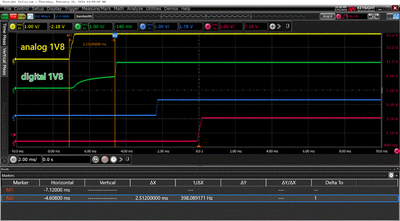

Dear Team,
When we measured the power-on sequence of the IMX8MN, we discovered voltage leakage on NVCC_1V8. We subsequently double-checked the power rail on the EVK and found no such issue.
According to the specifications, we are still meeting the timing requirements, and the device is able to boot up normally. Is the voltage leakage on NVCC_1V8 acceptable?
Justin.
