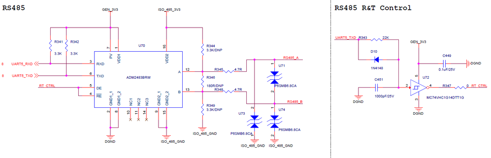

Hi Sir,
Currently, I am working on the IMX8dxp processor, but I meet some problems in linux driver of fsl-lpuart.c.
On my hardware we want to use an hardware rs485 transceiver to connect with our uart0 port and use another gpio to control the flow.
And now the transceiver's tx and tx connect the tx and rx of UART0
The RE of transveiver connect the uart0_de[SPI0_CS0], it is not the general of cts or rts pin of uart.
So you could see the schematic from the attachment.
I want to confirm if our driver could support this rs485 logic.
I modified the dts but not working. the flow conftol pin was not controlled.

Hello yang_wang-wy ,
The UART in i.MX8 is LPUART. If you want to use software to control the direction of RS485 receiving and sending data, you need to use the RTS_B signal. However, lpuart driver does not support RS485 mode. If you need to use it, you need to add RS485 function yourself.
In addition, the hardware can also realize the automatic data receiving and sending of RS485. See below, please!
Have a nice day!
B.R,
Weidong

Hi Weidong,
Thanks for your replay.
I also have an question about the schematic demo circuit.
I want to know if your demo circuit could support all bitrate of uart or I need to customize the circuit for different bitrate?
Currently, I need to support the following bitrate
B115200, B38400, B19200, B9600, B4800, B2400, B1200
