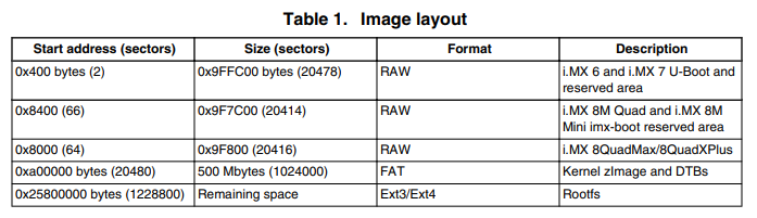

1、can this fsl-image-qt5-validation-imx-imx8mqevk.sdcard  be burnt in SDcard?
2、SDcard file system is exFAT?
3、how to make a boot SDcard? I followed the user manual but failed

1.- Yes, it is an image ready to be flashed on your SD/MMC.
2.- The image layout is as following:
3.- You'll need to follow the i.MX_Linux_User's_Guide.pdf be it using UUU, section 4.2 Universal update utility, or by using a  PC with Linux OS, section 4.3.2 Copying the full SD card image.
Hope this helps
Aldo.
