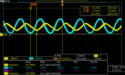

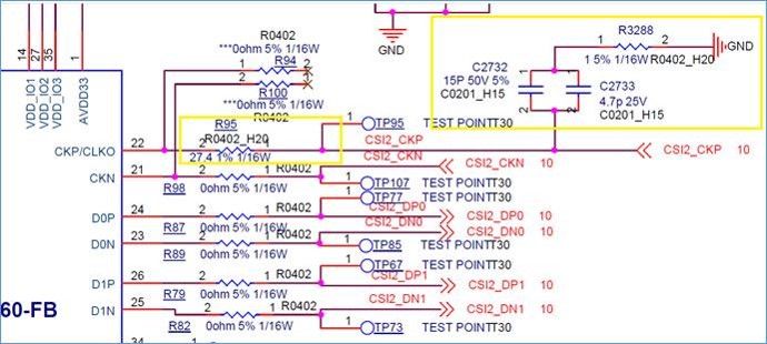

We have two unit, one is okay to capture, and the CLK signal is like "MIPI_CLK1.png".  The other one cannot capture image normally with high probability (90%), we measure the CLK signal, the signal looks fine as "MIPI_CLK1.png".  After adjusting damping resistor by our HW on the issue unit, it can capture images normally.
Are there any methods about adjusting the IMX8 setting like changing damping resistor?
Environment description: IMX8MP + TP2860 decorder + MIPI CSI + 2 lane
- Signal that cannot capture images before adjusting damping resistor on the issue unit.
- Signal that can capture images after adjusting damping resistor on issue unit, it looks shift but is workable.
HW modification is as below and attached "MIPI_hw_modify.png"

The root cause should still be hardware layout.

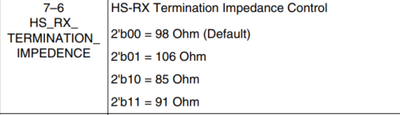

You can try to adjust HS_RX_ TERMINATION_ IMPEDENCE bit in  MIPI_CSIx_DPHY_SLAVE_CTRL_LOW  register. This is a software workaround but may not solve this issue very perfectly.

We try to modify three type of MIPI_CSIx_DPHY_SLAVE_CTRL_LOW  registers as attached patch, but it seem not work on the issue unit.
