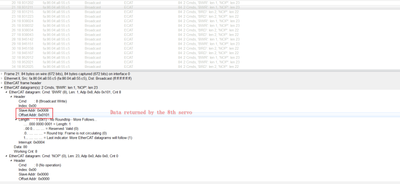

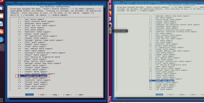

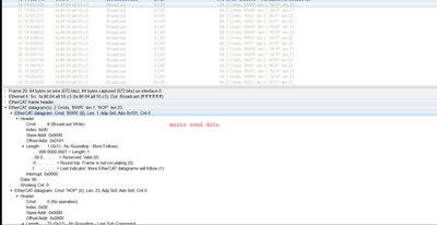

Thank you for your answer. My other development board, imx6q, also reported a frame error but it can communicate normally. It seems to be another problem. Can you continue to help me? imx8q sends Ethercat packets. I use wireshark to capture the packets and observe that the servo returns data, but the master station does not seem to have received the data packets returned by the servo.
Is it a Socket compatibility issue? The kernel of imx8mm has no Socket match support setting
