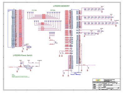

This IS the EVK demo board (imx7ulpevk). I was trying to run the stress test on that. (This is also the board I am trying to configure for 2GB of memory, sense the memory chip that comes on the board is 8GB.
The memory should be fine, I have compiled and ran many different images on it, and everything seems to work great. The calibration seems to work fine when I set it to the 320MHZ it is supposed to run at.
I assumed there would be some documentation for how to reconfigure the demo board for 2GB.
5,305 Views
igorpadykov
if this is NXP i.MX7ULP EVK reference board, it has only 1GB LPDDR3 memory as described
in documentation, for example p.8 schematic  spf-29163
MCIMX7ULP-EVK Design Files
https://www.nxp.com/design/development-boards/i-mx-evaluation-and-development-boards/evaluation-kit-...
igor
5,298 Views
meb99
That schematic has that you shared has "NT6CL256T32CQ-H1" which is a 4GB LDDR3 module. I attached the datasheet for it. Not only that if you look at the bottom right it has the "AC11" -> DDR_ZQ1 for "2GB LDDR3". I might be missing something, but as far as i can tell this should have all the wiring to configure it for 2GB.
On a side note every single Application Board here has only 1GB of memory.
https://www.nxp.com/products/processors-and-microcontrollers/arm-processors/i-mx-applications-proces...
I know that section 22.5.4.2.2 of the application processor reference manual goes through configuration settings for 2GB of memory with 1 GB per chip select which the included memory module has. I admittedly have not gone through that as I was hoping the the Aide you referenced would provide those.
Any detail on why what exactly there is a 1GB limitation on the board would be helpful! thank you

igorpadykov
Table 19-1. System memory map Reference Manual describes "DDR (1024 MB)" as available capacity.
i.MX7ULPRMB2: i.MX 7ULP Applications Processor Reference Manual for Silicon Revision B2
igor

igorpadykov
Hi meb99
yes it is confirmed, correct is Table 19-1. System memory map Reference Manual :
