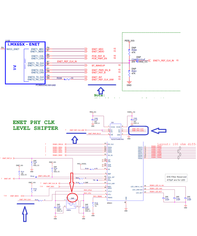

BiyongSUN
I reviewed the schematic Ethernet1.pdf. For usinng ar8035 hardware design.
Please refer to the the hardware design for dual ethernet ar8031 in i.MX6SX. Please pay attention to the connections of clocks.
It should use the i.MX output for ar8035 or  using ar8035 for feeding i.MX clock.
In the i.MX6SX has those options.
i.MX6SX schematic:
