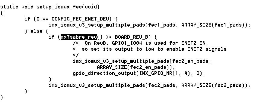

igorpadykov
Hi Srikant
from log: "i.MX7D SABRESD RevA" was used, while fec2 is used for board revisions
starting from rev.B according to comments in mx7dsabresd.c setup_iomux_fec() :
On RevB, GPIO1_IO04 is used for ENET2 EN..
http://git.freescale.com/git/cgit.cgi/imx/uboot-imx.git/tree/board/freescale/mx7dsabresd/mx7dsabresd...
igor

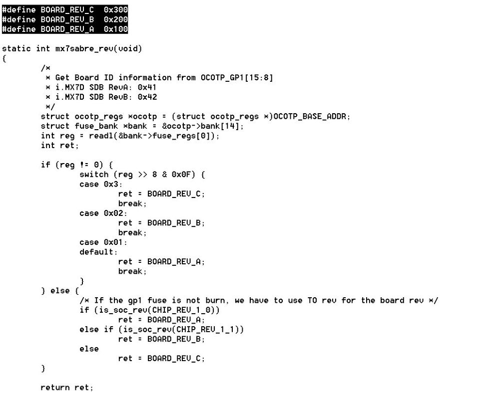

skrishnakar
Hi igorpadykov‌,
This is actually a Rev-D board and same query was raised in my previous communications that despite of Rev-D specified on board the u-boot display the message as "Rev-A" because there is no conditional code in u-boot to show Rev-D see:
Line 275-277:
#define BOARD_REV_C  0x300 #define BOARD_REV_B  0x200 #define BOARD_REV_A  0x100
then Line 291-303:
     if (reg != 0) {           switch (reg >> 8 & 0x0F) {           case 0x3:                ret = BOARD_REV_C;                break;           case 0x02:                ret = BOARD_REV_B;                break;           case 0x01:           default:                ret = BOARD_REV_A;                break;           }
The Rev-D board defaults to Rev-A hence u-boot displays it as per the default case depicted above. Can you kindly confirm if I have misinterpreted the above setup ? My board has J36-J39 pins that were being referred while using EPDC panel.  Does this u-boot show Rev-D for all latest i.MX7D boards ?
Thanks a lot!
-Srikant

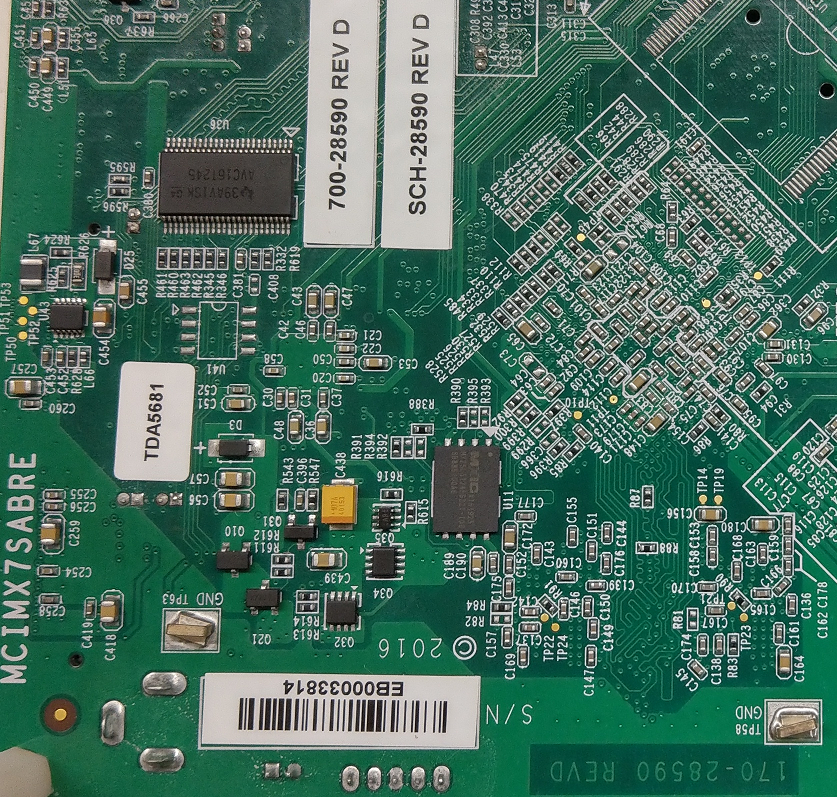

skrishnakar
Hello igorpadykov‌,
Can you confirm from the above picture whether the board that we are using is Rev-D or Rev-A ? Since all the code used for Rev-A is being used by the latest board even though it is considered as Rev-D ? These boards are dated 2016.
Srikant
5,956 Views

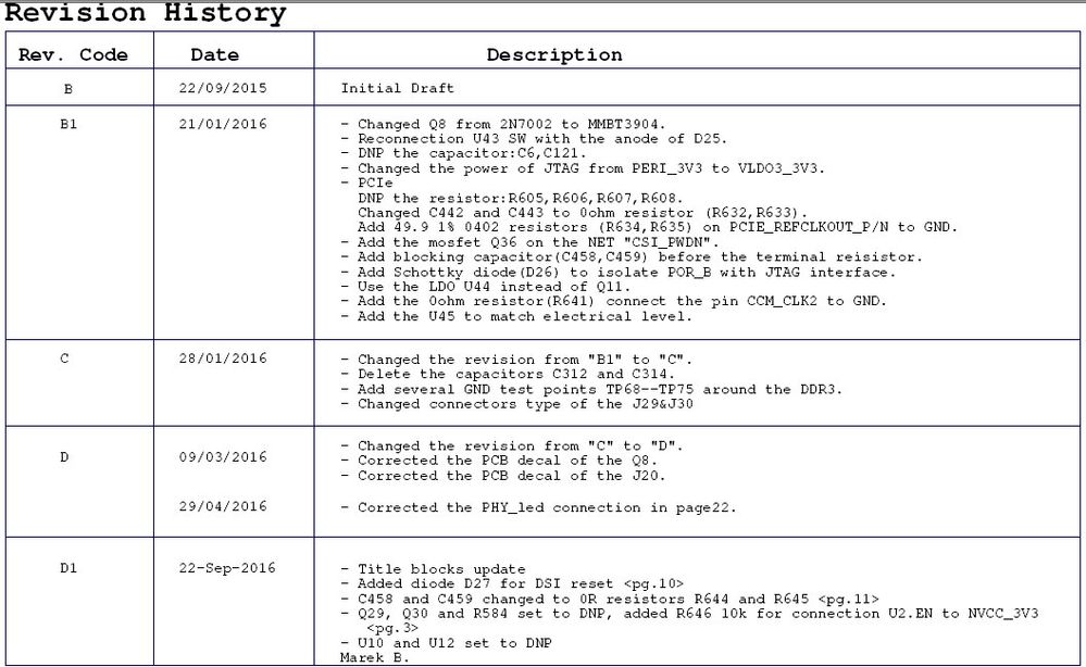

igorpadykov
Hi Srikanth
on first page schematic there is description of changes rev.A vs D, one can check them:
Schematics (2)
Design files for i.MX 7Dual (REV D)
Design files, including hardware schematics, Gerbers, and OrCAD files for i.MX 7Dual (REV D)
http://www.nxp.com/products/microcontrollers-and-processors/arm-processors/i.mx-applications-process...
one can try to change board settings so it was identified as "D" and used signal GPIO1_IO04 for ENET2 EN.
Please check this with oscilloscope.
igor

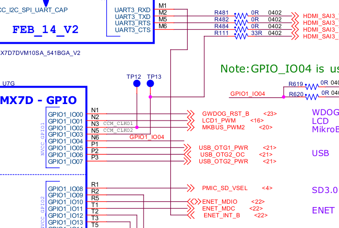

skrishnakar
Hi igorpadykov‌,
I did look into the documents suggested by you and it depicts the EPDC/ENET2 configuration usage, but I couldn't find relevant instructions to change the hardware from Rev-A to Rev-D, the change-log of Rev-D does not reveal much to make a default board Rev-D.
If you don't mind, would you kindly point me to exact information that I am looking for in the schematics ? The ENET interrupt pin seems to be muxed with UART3 RXD as seen below:
Is that a jumper or switch setting which turns this board to Rev-D from Rev-A ?
Thanks for your patience!
Srikant

igorpadykov
Hi Srikant
Rev-D changes:
code in mx7dsabresd.c which identifies board revision:
igor

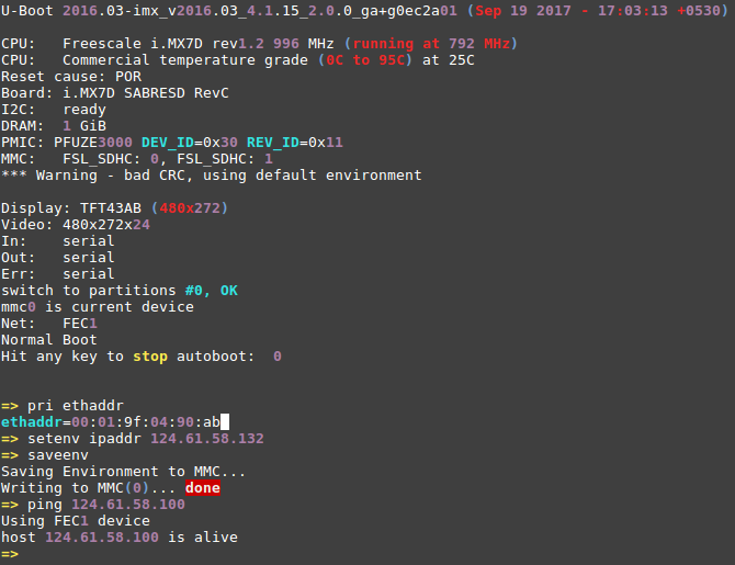

skrishnakar
Hi igorpadykov‌,
I was assuming there is a hardware setting or rework that would make it a permanent configuration hence I was asking for reference in schematics, but since you pointed back to u-boot board/machine file, I did the change in u-boot source i.e defaulting to Rev-C and changing the ENET device to 1 made it work:
Thanks a lot igorpadykov‌ for your continuous support on this. I hope I can use this as default setting on this board.
Srikant
