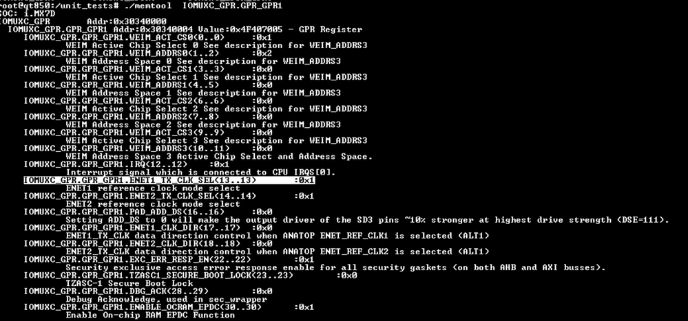

I am using an external clock from DP83825, the clock seems to be ok from DP83825. I have made the changes accordingly in mach-imx7d.c as follows:-
if (!IS_ERR(gpr)) {
        if (IS_ERR(enet_out_clk)) {
            pr_warn("%s: failed to get enet_out clock, assuming ext. clock source\n", __func__);
            /* use external clock for PHY */
            regmap_update_bits(gprIOMUXC_GPR1IMX7D_GPR1_ENET_TX_CLK_SEL_MASKIMX7D_GPR1_ENET_TX_CLK_SEL_MASK);
            regmap_update_bits(gprIOMUXC_GPR1IMX7D_GPR1_ENET_CLK_DIR_MASK0);
        } else {
            pr_warn("%s: found enet_out clock, assuming internal clock source\n", __func__);
            /* use internal clock generation and output it to PHY */
            regmap_update_bits(gprIOMUXC_GPR1IMX7D_GPR1_ENET_TX_CLK_SEL_MASK0);
            regmap_update_bits(gprIOMUXC_GPR1IMX7D_GPR1_ENET_CLK_DIR_MASKIMX7D_GPR1_ENET1_CLK_DIR_MASK);
            clk_put(enet_out_clk);
    } else {
        pr_err("failed to find fsl,imx7d-iomux-gpr regmap\n");
I went through this thread i.MX7 RMII 50MHz clock and found that for me as well ENET1_REF_CLK_ROOT is 0. Shall this bit be set or not, if using the external clock to ENET1?  Could you please provide some info on this, I am not clear after reading imx7d reference manual.
./memtool CCM.TARGET_ROOT78
SOC: i.MX7D
CCM Addr:0x30380000
CCM.TARGET_ROOT78 Addr:0x3038A700 Value:0x00000000 - See Target Interface for more information.
If it needs to be set while using the external clock as well, please suggest me how can I do it?
Other than this, am I missing anything to implement for ethernet?

igorpadykov
Hi Asma
what bsp used in the case, referenced  thread  issue should be fixed in last bsps.
Reference clock direction is defined by bit ENET1_TX_CLK_SEL,
register IOMUXC_GPR_GPR1 described in sect.8.2.4.2 GPR1 General
Purpose Register (IOMUXC_GPR_GPR1)
i.MX 7Dual Applications Processor Reference Manual
 In NXP i.MX7D Sabre uboot it is configured in function setup_fec()
mx7dsabresd.c\mx7dsabresd\freescale\board - uboot-imx - i.MX U-Boot
RMII example can be found in imx7 colibri board
uboot-imx/colibri_imx7.h at imx_v2018.03_4.14.98_2.0.0_ga_var01 · varigit/uboot-imx · GitHub
uboot-imx/colibri_imx7.c at imx_v2018.03_4.14.98_2.0.0_ga_var01 · varigit/uboot-imx · GitHub
igor

asmaa
Contributor V
I am using 4.19.35.
I checked IOMUXC.GPR_GPR1 register for ENET1_TX_CLK_SEL. It is set to 1. I think this is right.
