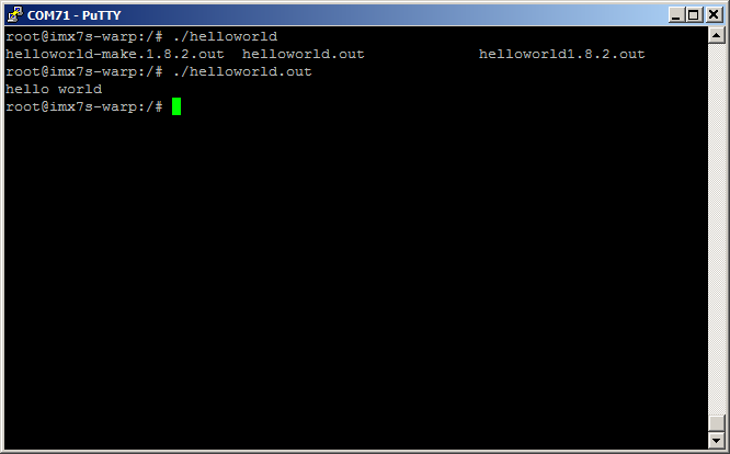

the issue got resolved by compiling the helloworld.c as shown below:
$ bitbake meta-toolchain
bheema@Bheema:~/fsl-warp7-yocto/build-x11-machine-test$ /home/bheema/fsl-warp7-yocto/build-x11-machine-test/tmp/deploy/sdk/poky-glibc-x86_64-fsl-image-machine-test-cortexa7hf-neon-toolchain-2.1.2.sh
toolchain gets install at /opt/poky/2.1.2
and while compiling for target warp7 board we have to follow below steps:
root@Bheema:~/warp_appln# source /opt/poky/2.1.2/environment-setup-cortexa7hf-neon-poky-linux-gnueabi
root@Bheema:~/warp_appln# ${CC} helloworld.c -o helloworld.out
