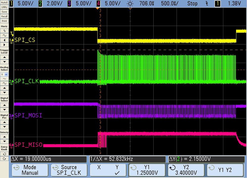

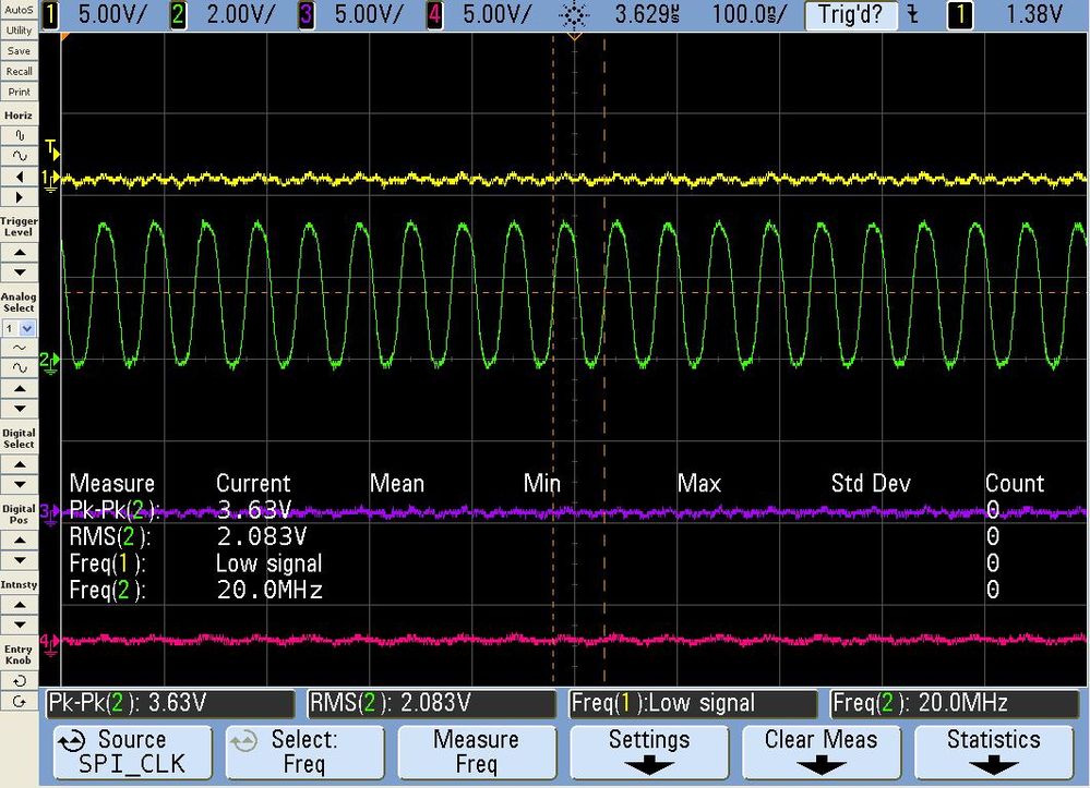

I'm having problems accessing spi nor flash using u-boot console. Write/read operations are failing unless data size is small.
=> sf probe
SF: Detected W25Q16JV with page size 256 Bytes, erase size 64 KiB, total 2 MiB
=> sf erase 0 0x200000
SF: 2097152 bytes @ 0x0 Erased: OK
=> mw.b 0x00900000 0x0 0x20000
=> mtest 0x00900000 0x0090ffff 0x12345678 0x1
Testing 00900000 ... 0090ffff:
Pattern 12345678 Writing... Reading...Tested 1 iteration(s) with 0 errors.
Write operation:
=> sf write 0x00900000 0x0 0x1000
device 0 offset 0x0, size 0x1000
SF: 4096 bytes @ 0x0 Written: OK

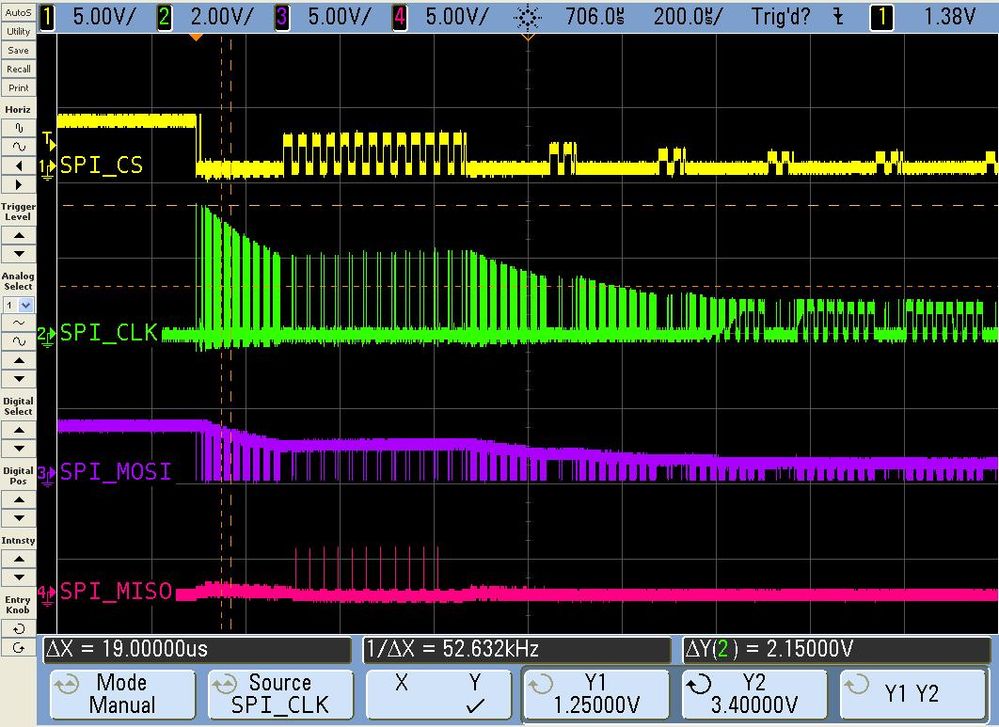

I don't know why this behavior. SPI signal levels should not decrease like that.
Read operation:
=> sf read 0x00910000 0x0 0x1000
SF: 4096 bytes @ 0x0 Read: OK
2020-03-04-2-imx6ullcom-4_spi_nor_signals_read.jpg2020-03-04-2-imx6ullcom-4_spi_nor_clk.jpg
Comapare OCRAM write buffer vs OCRAM read buffer:
=> cmp 0x00900000 0x00910000 0x1000
word at 0x00900100 (0x123456b8) != word at 0x00910100 (0xffffffff)
Total of 64 word(s) were the same
64 words are ok, the rest not.

Hi Carlos
regarding "signal levels" one can try to incresae drive strength
MX6_PAD_CSI_DATA pads using DSE field in IOMUXC_SW_PAD_CTL_PAD
registers, like in sect.32.6.257 SW_PAD_CTL_PAD_CSI_DATA06 SW PAD Control
Register (IOMUXC_SW_PAD_CTL_PAD_CSI_DATA06)
i.MX 6ULL Applications Processor Reference Manual
also one can check with oscillocope power supplies spi-nor flash and NVCC_CSI
power which supplies these pads according to Table 91. 14 x 14 mm Functional Contact Assignments
i.MX 6ULL Applications Processors for Consumer Products
igor
4,580 Views
carbar
Hello Igor,
we had a error in our design and for some reason the resistor that  connects  NVCC_CSI  to DCDC_3V3 (from PMIC ) was not present. Now read/write to spi nor is working ok, and booting from spi nor too.
Carlos
