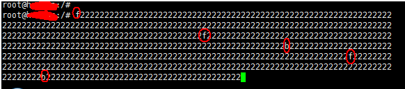

Hello
      I have change the baseline from L4.1.15 to L4.14.98. then faced a new problem. that the uart(5) rx/tx is not stable. pls see:
      I keep typing in char '2', but the seems the some bytes is wrong.
      I have read this topic:
      imx6ul - UART Rx dropping/corrupting bytes
      so there is two question:
      1:  How to change the default configuration of UART, DMA or interrupt.
      2:  How to increase rx/tx recieve buf size?

igorpadykov
Hi 国承 张
as mentioned on above link: " Using flow control (RTS/CTS) for UART with
DMA is absolutely necessary to avoid data lost."
For changing to interrupt configuration one can try to remove "dma" in dts, as in "uart1":
imx6ul.dtsi\dts\boot\arm\arch - linux-imx - i.MX Linux kernel
Seems "buffer size" implies threshold levels  in UARTx_UFCR register.
igor
