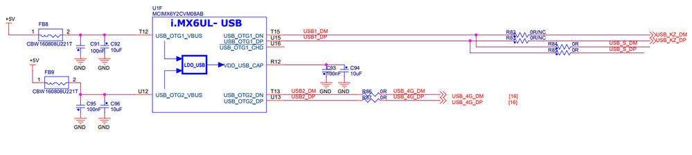

In our custom imx6ull board, we use USB_OTG2 as usb host connect to 4G modem, and  USB_OTG1 as usb host connect to a USB typeA interface.
In most case USB_OTG1 can success recognize a inserted Udisk, and there is a 3% probability that cannot  recognize. when in that abnormal situation, we try a lot unplug and insert, but the Udisk was not successfully recognized even once, we also try other usb device,eg. USB mouse, other brand Udisk is the same. And in that abnormal situation,USB_OTG2 can success to recognize unplug and insert 4G modem.
root@Router:/etc# lsusb
Bus 002 Device 001: ID 1d6b:0002 Linux Foundation 2.0 root hub
Bus 001 Device 001: ID 1d6b:0002 Linux Foundation 2.0 root hub
So in the beginning we think this mybe a hardware issue, because there is only 5% probability custom imx6ull board exist this issue,but in that abnormal situation if we try  "rmmod ci_hdrc_imx" and then "modprobe ci_hdrc_imx"  (sometime need try twice),USB_OTG1 can success to recognize the Udisk. So now i  think there may be also a "ci_hdrc_imx" driver bug.

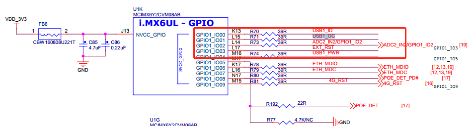

Here is
our Dts
 pinctrl_usb_otg1: usbotg1grp {
fsl,pins = <
MX6UL_PAD_GPIO1_IO00__ANATOP_OTG1_ID 0x17059
MX6UL_PAD_GPIO1_IO01__USB_OTG1_OC 0x17059
&usbotg1 {
dr_mode = "otg";
pinctrl-names = "default";
pinctrl-0 = <&pinctrl_usb_otg1>;
status = "okay";
our hareware sch:

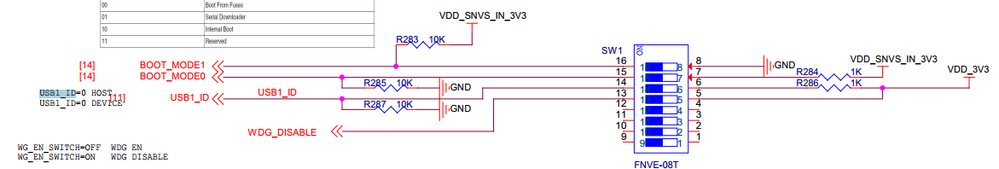

And i  think the "dr_mode = otg" in usbotg mode will auto switch dr_mode every USB driver install by detect USB1_OTG_ID gpio level.  (In our design USB1_OTG_ID alway pull-down with 10K )

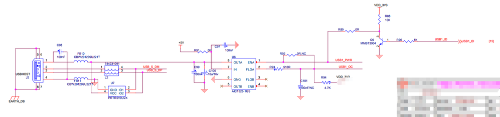

1. Your USB OTG1 should be configured as HOST mode.
--USB OTG1 ID PIN should be pulled down to LOW via a resistor(such as 2.2K)
--5V on board should be conencted to USB OTG1 VBUS and VBUS PIN On USB TYPE-AF connector.

1、indeed USB OTG1 ID PIN was allready low at that time(SW1.6 is off ),

2、"+5V" on board is directly conencted to USB_OTG1_VBUS pin, and indirectly conencted to USB TYPE-AF connector's VBUS pin through a current limiting IC. we checked no voltage drop with “+5V” at that time.
So @weidong_sun we don't really think this problem is a fully hardware issue, beacuse  if we try uninstall and then install driver ci_hdrc_imx("rmmod ci_hdrc_imx" and then "modprobe ci_hdrc_imx"), USB OTG1 became work well.
