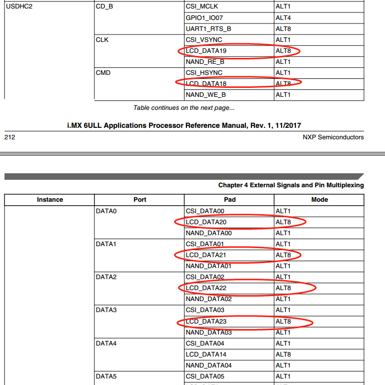

你好,我想用6ull接16位dsp,才用复用数据线地址线的方式,nand emmc,不能用了,sd1可以用,这个sd1是不是可以接emmc 然后采用4bit的方式,来作为启动设备呢?如果不行,是否k可以用LCD_DATA19-23来接emmc,作为启动设备?

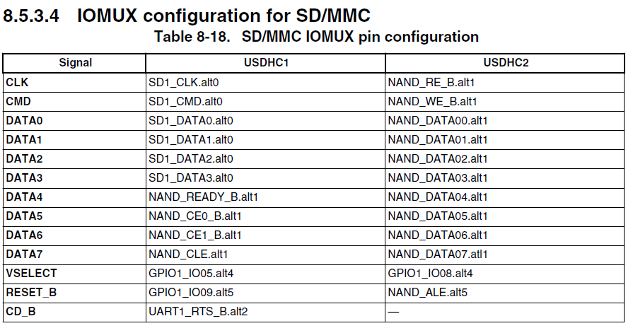

The SD1 can be use connect the 4bit emmc. Here you ask about if you can use the LCD_DATA19-23 to connect the emmc and boot up, the answer is no. From our RM you can see the Table 8-18. SD/MMC IOMUX pin configuration, you can see that the emmc boot up USDHC2 from NAND not the LCD_DATA.
Hope this can do help for you.
