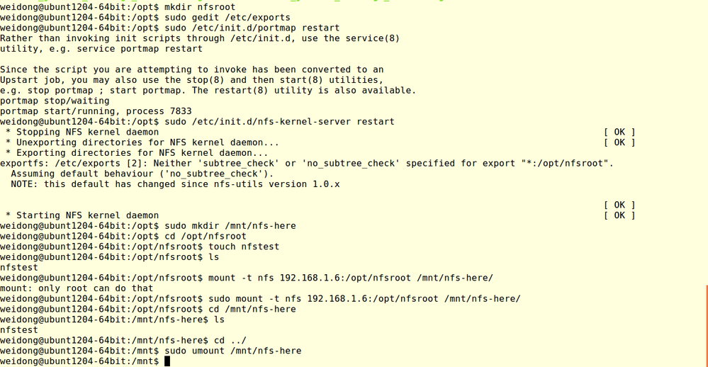

2. Setup NFS server
(1) Install NFS server package
#sudo apt-get install nfs-kernel-server
(2) Create NFS directory:/opt/nfsroot
# mkdir /opt/nfsroot

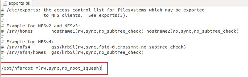

(3) Configure mounted directory and authority
# sudo gedit /etc/exports
Add the following line at the end of the file:
/opt/nfsroot *(rw,sync,no_root_squash)
(4) Restart the NFS service
#sudo /etc/init.d/portmap restart
#sudo /etc/init.d/nfs-kernel-server restart
(5)Test NFS server
# sudo mkdir /mnt/nfs-here
# cd /opt/nfsroot
# touch nfstest
# sudo mount -t nfs 192.168.1.6:/opt/nfsroot /mnt/nfs-here/
# cd /mnt/nfs-here
# ls
Then you will find nfstest file is here , It indicates that your
NFS server is correctly working.
Note : If you want to cancel the above mounting , you can use this
command:
# cd /mnt (or cd ../)
# sudo umount /mnt/nfs-here
NOTE:
To restart network , the following Command can be used :
Restart Network : sudo /etc/init.d/networking restart
