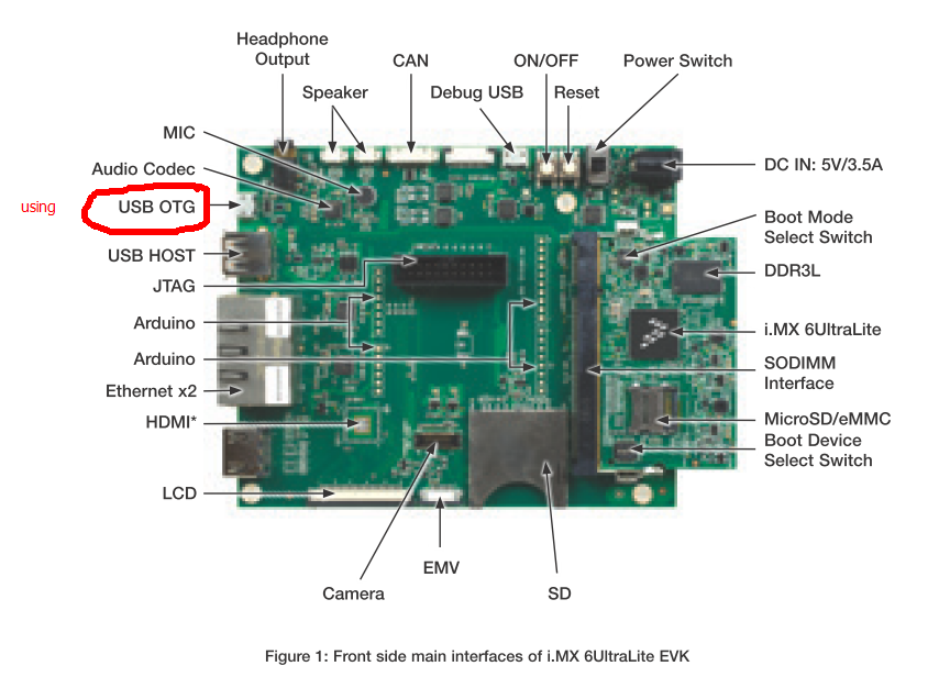

2,879 次查看
半醒的狐狸
hi igorpadykov
    i'm very sorry to trouble you。
    i found the  reason of the problem .
    same days ago ,i altered the dts  in  &iomuxc,i delete same Pin definition....
    today, i use the default dts,and i can use the usb OTG..
    thanks for all you help!
li

my board:
i use the usb otg to connect the pc..

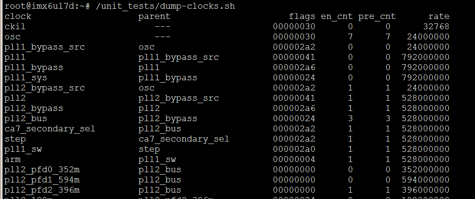

2,879 次查看
半醒的狐狸
hi igorpadykov
    thanks for you help,i saw the  description in /doc,but i can't understand the dump-clocks.sh.
what's the mean of the "flags"  、"en_cnt"、"pre_cnt"?
i can't found the description of this..
thanks!
