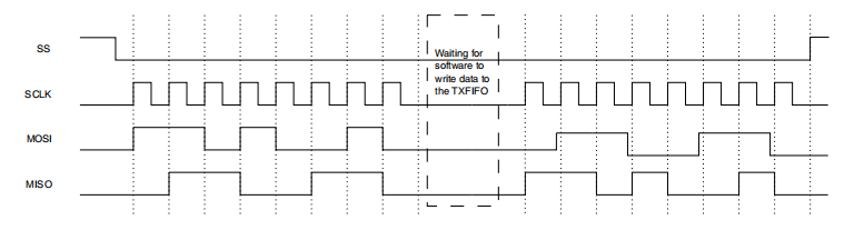

hi:
There is currently a peripheral spi regmap API used for read and write operations,  in ecspi3 bus connection,The cs pin is configured as required cs function which automatically generates a CS signal, not configured GPIO function to generate a CS signal manually .
dts configuration is as follows:
                pinctrl_ecspi3: ecspi3grp {
                        fsl,pins = <
                                MX6UL_PAD_UART2_RTS_B__ECSPI3_MISO        0x100b1  /* MISO*/
                                MX6UL_PAD_UART2_CTS_B__ECSPI3_MOSI        0x100b1  /* MOSI*/
                                MX6UL_PAD_UART2_RX_DATA__ECSPI3_SCLK      0x100b1  /* CLK*/
                                MX6UL_PAD_UART2_TX_DATA__ECSPI3_SS0       0x100b1  /* CS*/

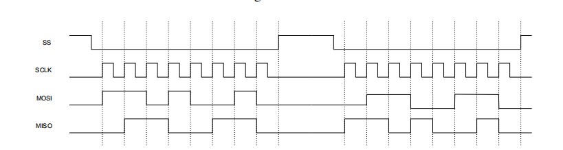

However, the automatic generation CS / SS signals are as follows:
But my spi peripherals required CS / SS signals, as follows
How do I modify the kernel and dts?

2669889282
hi igorpadykov
patch does not solve my problem
SPI requires native chip select lines which automatically generates a CS signal ,instead of using the GPIO  generates  signal CS manually
