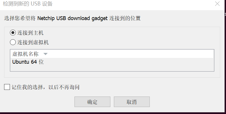

② When I plug in the USB port, it would show the choose of accessing ubuntu. But when I used uuu to burn, the hint showed again.
③ The Ubuntu interface is shown below:

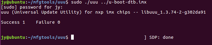

     And I have ever had the same view. But when I looked log like the picture as follows, I confused. If  the eMMC is not populated, why could it success ? It even could boot the u-boot but not find the kernel obiviously. This is my previous attempt and I couldn't show it again. I burned it with no sdcard inserted. Did I burn it to other memory ? Looking forward to your reply.

When you run the tool by using the following command:
$ sudo ./uuu <bootloader>
It will only download uboot to the internal RAM it isn't burnt on the eMMC or SD.
For example if you want to burn only uboot into the eMMC you'll need to use this command:
$ sudo ./uuu -b emmc <bootloader>
That in this case it will fail as it did in your previous attempt due to the absence of the eMMC.
