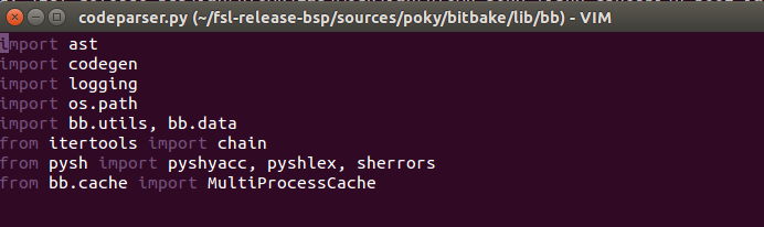

chunqiaohe
Hi Muhin:
     thanks for your replay. i follow the user's Guide to setup host environment. and try to build core-image-minimal first.
but there also have issue. please see  the log:
 form the log , you can see the error is "File "/home/chunqiao/fsl-release-bsp/sources/poky/bitbake/lib/bb/codeparser.py", line 1, in <module>
import ast
ImportError: No module named ast" .
i open the codeparser.py file,  the error is form here. but  how to change?

Yuri
    Perhaps it makes sense to use separate (clean) Linux (U-buntu, Debian) installation as Virtual Machine.
