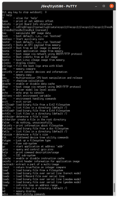

I was trying to load and run a hello_world example from FreeRTOS_BSP_1.0.1_iMX6SX/examples/imx6sx_sdb_m4/demo_apps/hello_world/armgcc (built with ./build_debug.sh) into Cortex M4 by putting the .bin file in the fat partition of the SD card, then booting the board from SD Card and stopping the u-boot before loading the kernel and giving these commands:
setenv m4image hello_world.bin
setenv m4runaddr 0x7f8000
setenv loadm4image 'fatload mmc ${mmcdev}:${mmcpart} ${m4runaddr} ${m4image}; dcache flush'
setenv m4boot 'run loadm4image; bootaux ${m4runaddr}'
saveenv
run m4boot

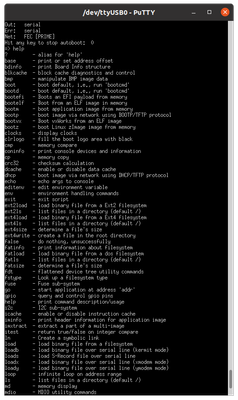

The problem is that the command bootaux is not present as you can see in the following image:
This command is  available, instead, in the U-boot in the original SD Card provided with the SABRE iMX6sx:
How can I make this command available in my custom build too?

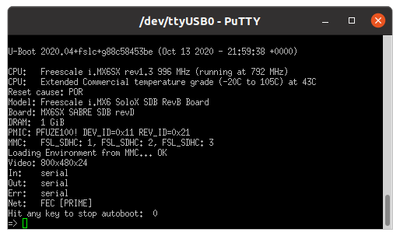

We built our custom core-image-minimal starting from https://github.com/Freescale/fsl-community-bsp-platform -b dunfell repository.
This is how our U-boot looks like:

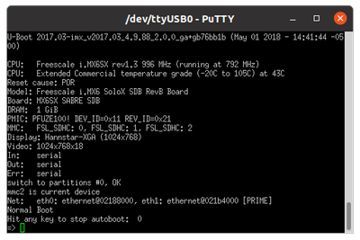

and this is the one in the Original SD Card:
By the way, I tried to accomplish the same task using the Original SD Card
but no output is coming out from the M4 uart. Have I to modify anything? Do you confirm that I have not to modify the .dtb files related to the kernel?

Please try by adding the following to your defconfig:
CONFIG_IMX_BOOTAUX=y

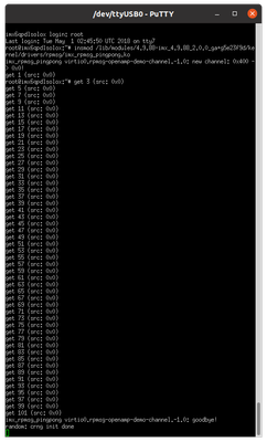

At the same time I was trying the freertos pingpong example provided in the FreeRTOS_BSP_1.0.1_iMX6SX/examples/imx6sx_sdb_m4/demo_apps/rpmsg/pingpong_freertos. After compiling and copying the rpmsg_pingpong_freertos_example.bin to the SD Card I Switch on the board and stop normal booting. After that I run the rpmsg_pingpong_freertos_example.bin and in the M4 core serial interface i see this output
RPMSG PingPong FreeRTOS API Demo...
RPMSG Init as Remote
After that I boot the A9, log in and give the command:
insmod /lib/modules/4.9.88-imx_4.9.88_2.0.0_ga+g5e23f9d/kernel/drivers/rpmsg/imx_rpmsg_pingpong.ko
On the A9 side I see this:

On the M4 side I expected to see the string "Name service handshake is done, M4 has setup a rpmsg channel [src ---> dst]" and then some strings "Get Data From Master Side: data", like this:
M4 has setup a rpmsg channel [---> 1]
Get Data From Master Side: 1
Get Data From Master Side: 3
Get Data From Master Side: 5
Get Data From Master Side: 7
but I only see a succession of incomprehensible characters.
Despite this, on the A9 side it would still seem that the data is correctly increased.
