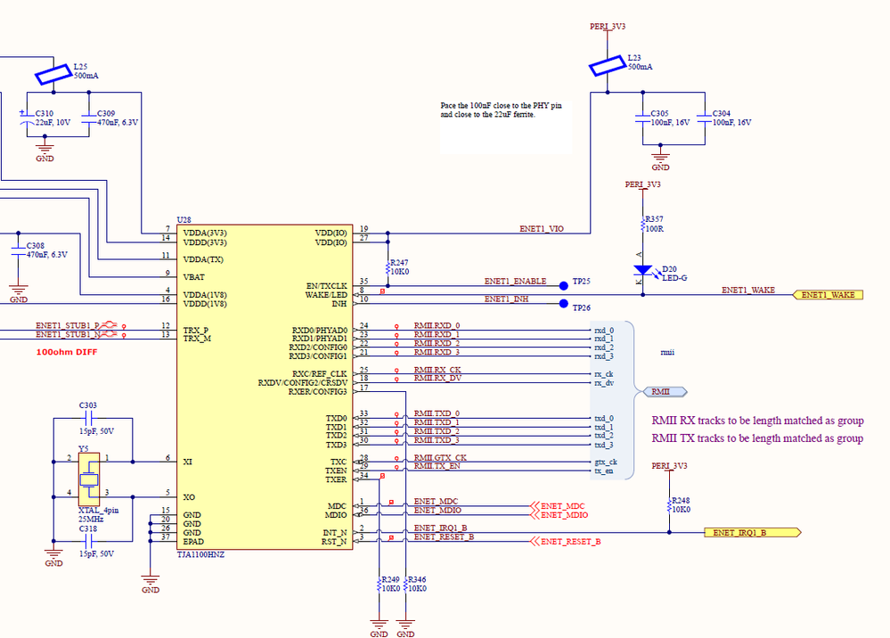

Hi there,
We have an imx6sx in a custom board with 2 ethernet phys: one is a TI DP83867 and one is an NXP TJA1100 automotive phy. The design is based on the Sabresd dev board. I have a problem configuring the mdio bus to recongnize both phys. The TJA1101 is always seen on the bus but the DP isn't. The TJA1101 uses RMII mode and the DP uses RGMII mode. The phy side of the dp is fine; clocks to the DP are fine - 25MHZ because it's limited to 100Mbits; the DP driver is in the kernel; the activity led bursts into life both ends when a cable is connected; the DP is recognized in u-boot as eth0 [ PRIME ] ( I had to change the mask in fec_phy_init function in fec_mxc.c, because the phy id is 0x1f ). However, linux cannot find the phy and doesn't load the driver ! The mdio bus cannot see the DP phy but can see the TJA1101.
The schematics are:
DP83867:
TJA1100:

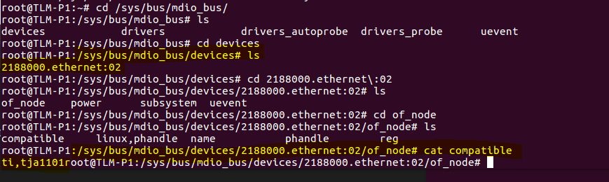

My questions are: is the configuration - especially the device tree - correct ? Why can't the mdio driver recognize the dp chip on the bus ? Even when the TJA1101 is held in reset, it still registers on the mdio bus and but mdio can't find the DP, despite the phy activity light showing the DP working. Does the FEC and mdio allow for the fact that a) both phy's are on the same mdio bus, and b) the DP is in RGMII mode and the TJA1101 is in RMII mode ?
As I understand it, the mdio driver will scan the bus for attached phy's. Does it need to be changed because the phy address of the DP is 0x1f. I also don't understand why the mdio node in the device tree is part of fec 1 but contains both phys, and fec 2 contains the second phy but it still shows up as part of fec 1:

Hi Igor,
thanks for your help. The problem was in our custom board circuit design. Both phy's default to address 0x00 on the mdio bus. Every phy requires a hardware strap configuration that will set a different address when it powers up, otherwise it will default to address 0x00. At least one of the phy's should be strapped to configure a different address, but we didn't have any straps on any phy. When we added a strap to the DP83867 to give it a different address to the other phy, everything started working perfectly.
thanks,
Mahtab

After some investigation, I guess the real question that could resolve this is:
Can you have two PHY's on one FEC ? And on the same MDIO bus ( in this case MX6SX_PAD_ENET1_MDIO__ENET1_MDIO / MX6SX_PAD_ENET1_MDC__ENET1_MDC ) ?
Every time I read the registers of the PHY in the kernel ( using for example phy_read(phy_dev, REG) ), I get the phy id of the TJA1101 ( 0x180dc41), which has a DEVADDR of 0,  I never see the phy id of the DP83867 ( 0x2000a231) , which has a higher DEVADDR of 0x1f. This kind of leads me to conclude that the FEC doesn't allow more than one device, and it will always pick the device with the first DEVADDR it finds on the bus.
Although, in principle, the mdio bus can cope with up to 0x1f ( 31 ) devices: the address length field for messages on the mdio bus is 5 bits.
