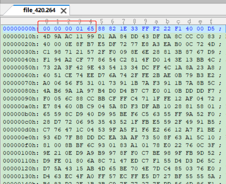

hi,
I encode I420 format yuv file to h264 by imx6q vpu , encode data is got(first frame 00 00 00 01 65 start, following picture blow), but there are not pps and sps datas.
I get sps and pps datas by function of libvpu:ret = vpu_EncGiveCommand(handle, ENC_PUT_AVC_HEADER, &enchdr_param), enchdr_param.headerType = SPS_RBSP and PPS_RBSP, mvc_paraset_refresh_en = 1 and avc_audEnable = 1 in structure EncAvcParam.
return is success, but  enchdr_param.size is zero, Why!
the LTIB version I using is L3.0.35_4.1.0_130816
Thanks very much~~~

I had looked at the VPU_API_Reference_Manual Rev L3.0.35_4.1.0, 09/2013, and mvc_paraset_refresh_en is not in the AVC structure but paraset_refresh_en is.
Could you please check if you're enabling the correct one?
Aldo.

Thank you for your answer. Sorry, there is something wrong with my description. I paraset_refresh_en=1, not mvc_paraset_refresh_en, I see in log that function vpu_EncGiveCommand(handle, ENC_PUT_AVC_HEADER, &enchdr_param) return sps data size is 0 also;
In addition, Is there the latest verion of vpu library and heards file of IMX6Q,Please give me a copy or the  download link,I make a try using latest version,
