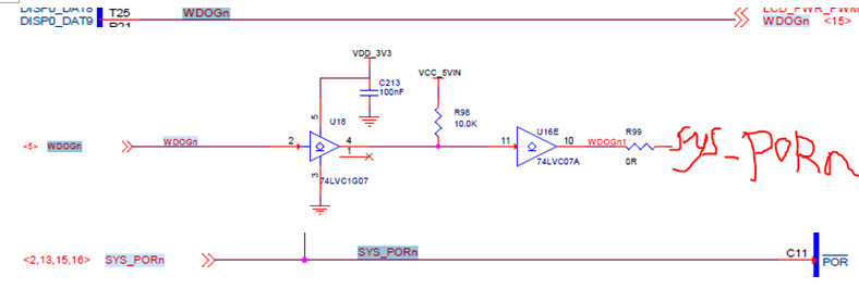

The imx6q board designed in this paper will have problems when it is reset after entering the Linux system.but when reset from uboot is ok. when reset from linux,the system will enter uboot,but just show the log is as follows,i can't operate Console

the reset circuit is designed as follows:
How can I solve this problem,can anyone help me?

Hi Andy,
Your reset design is to connect the WDOG signal to the POR_B pin. This connection method has a problem: When the CPU is in the standby or suspend state, the POR_B pin triggers the reset, which may cause the possibility of failing to start.
Because when in standby, the CPU frequency will decrease and the PMIC output voltage will decrease. If POR_B is triggered at this time, startup problems will occur. Because the PMIC output voltage is not enough to make the CPU run.
Therefore, it is recommended that you connect the WDOG signal to the PWRON of the PMIC and use the cold reset method to reset the system.

Thank you for your answer. I have solved this problem
