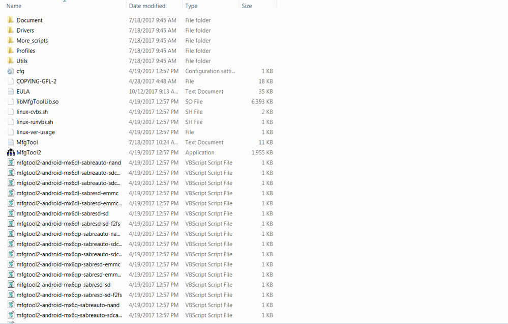

hi nxp,
        the mfgtools of Android 7.1.2_2.0.0 for imx6q not work;
              I download the android_N7.1.2_2.0.0_tools.tar.gz form nxp.com, and unzip it, but there is no                       mfgtools.tar.gz, but have mfgtools.zip, the size is only 4.28Mbytes;  after unzip, the sub dir is clean;
thanks for help !

kingplayer
update:
 partition-table.img is the new img file on andorid 7.1.2 release;  but the ucl2.xml from the previous mfgtool release not have partition-table.img, so the partition-table.img not flashing to the board;
     the borad can not bring up after flashing with the previous mfgtool, can't find partition:boot
   this is the log:

Yuri
  N7.1.2. MFG tool package on the Web is empty. Please look at "Android_Quick_Start_Guide.pdf",
in particular at section 3.3 (Flashing board images) how to use files from OS (demo) images, that may be
found on the Web.
https://community.nxp.com/docs/DOC-335604
Yuri.

kingplayer
first thanks for your response; and i means after  unzip the  mfgtools.zip, all sub dir is empty, mfgtools  can not opened
the size of mfgtools.zip on andorid 7.1.1 version is 62.4Mbytes, all sub dir have files; Document, Drivers, Profiles etc. and it work fine on android 7.1.1; but android7.1.2 can not open;
