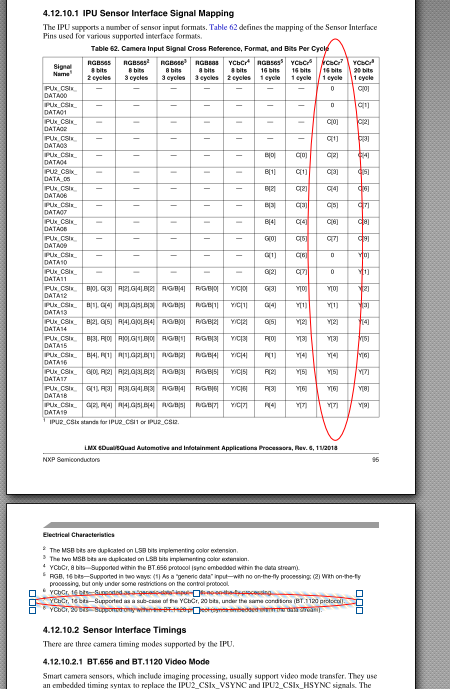

Hi All,
We are trying to get video from a camera sensor, which is connected to the ipu2-csi-2 parallel port. And we configured the CSI registers to get the video in 16 bit yuv format, but  we are not getting chroma section of the video .
We are using the 4.1.15 kernel and gstreamer as the application.
The sensor used is Sony FCBEV7520A, but the output from this sensor is LVDS and it is converted into CMOS 16 bit format using the chip THC63LVD1024.
We have also tried to get the video from Test pattern generator also.
Since Sony sensor does not have a test pattern option, with the other test pattern generator video, we could understand that there is no CrCb component in the video data, got at imx6 side.
The PINs used at imx6 side is as seen in the picture below,
And the CSI sensor configuration register is configured with following parameters,
  • 16 bit per pixel
  • YUV422 format
  • Gated Clock
The video obtained with this settings has only green color prominent, and that reveals that Cb and Cr values are zero and Y values varies according to video data.

Pls refer to the links as below:
iMX6 IPU TVIN Application Notes
https://community.nxp.com/docs/DOC-97981
If you use 16 bits data line, then only generic mode capture can be used to capture the 16 bits YUV data.
If one wants to capture YUV data in 16bits interface, onlt BT1120 can be supported, it needs camera output BT1120 protocol, and hardware data line should be CSI_DATA19 ~CSI_DATA12 and CSI_DATA9 ~CSI_DATA2.
