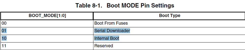

It's strange.In the newest reference manual, the boot mode pin setting is show in below picture. As you config BOOT_MODE  00 it worded, when changed to others it did not. So you'd better check the SD card, eMMC and other devices.
Best Regards
Dan
