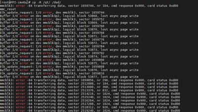

Hello, technical support:
      I made a imx6q board,When emmc works at 52m clock, it can't start properly. Manually modified to 13m clock, I can read and write the file correctly.

When you using the 52m, how about the log file of the board boot up?

Maybe I found some reasons. I used emmc5.1. the official board was emmc4.44. Is there a difference between the voltage configuration of the imx6q? Do you have a reference circuit for the emmc5.1 chip with imx6q.
I tested the voltage of the emml clk only 2.0v.but the official board was 3.3v.what caused the difference.

The design is the same, here which version BSP are you using?
