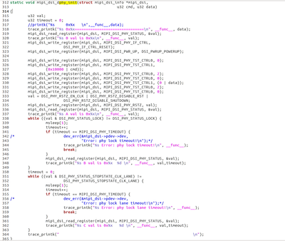

        I have do  test on system deep sleep and wake-up,when system wake up,the mipi lcd can't show anything ,kernel log prompts that " mipi dsi phy lock timeout    failed to init mipi lcd"
        add debug code trace_printk as below
    If  no phy lock time out, the MIPI_DSI_PHY_STATUS readed  value is 0x15BD,
      If  phy lock time out, it prints 0x1528
      refer to imx6DQRM.pdf,when phy lock timeout ,lane 0 and lane 1 not in stop state
     Anyone can help me ,why data lane 0 and lane 1 not in stop state,and phy lock timeout

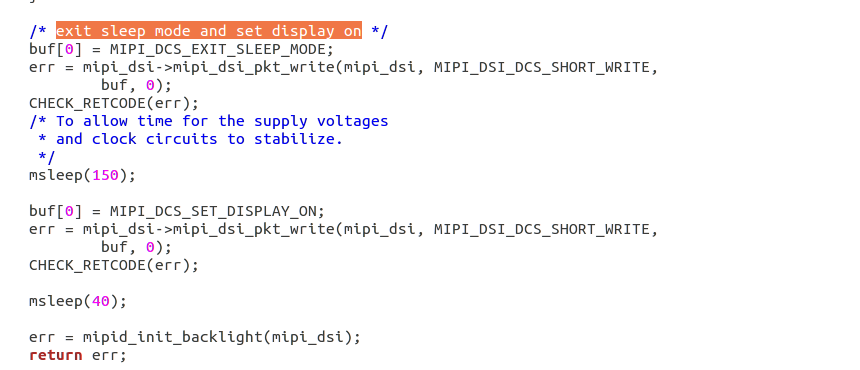

what bsp and panel used in the case. One can test it on i.MX6Q Sabre SD board
with TRULY WVGA LCD Modue(TFT480800-16-E), use Demo Image
SABRE for Automotive Infotainment based on i.MX 6QuadPlus, i.MX 6Quad and i.MX 6DualLite
For this panel one can look at sleep configuration in driver:
/* exit sleep mode and set display on */
https://source.codeaurora.org/external/imx/linux-imx/tree/drivers/video/fbdev/mxc/mxcfb_hx8369_wvga....

first  phy lock time out ,  then mipi lcd failed,
that is before mipi lcd init,mipi dsi already init failed,so why mipi dsi phy lock timeout
