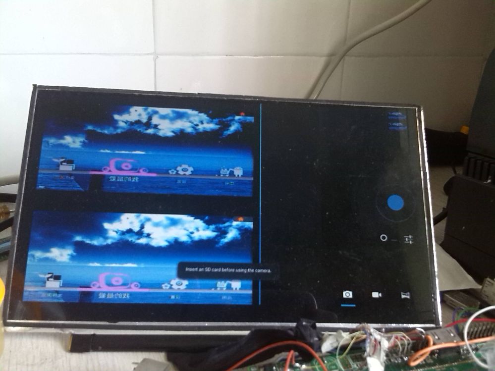

I'm work with android 4.3 + adv7180, When adv7180 work in gated mode, I can use camera apk to get image from adv7180, here's is the image I got from adv7180
There is 2 image in the screen because the image is not de-interleaved.

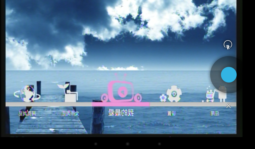

chuanyanyin
The hardware cause EAV/SAV error. I fix some hardareware problem. Now, I got this
1.png \
It look like the picture is mirrored.

chuanyanyin
Hi, Jaime
  No, you misunderstood, adv7180 has a crystal which work in 28.6363MHZ, so it doesn't need mclk to drive it , these are 2 picture of PAL or NTSC,Called even field and oll field.  Is there any software to put it together?
