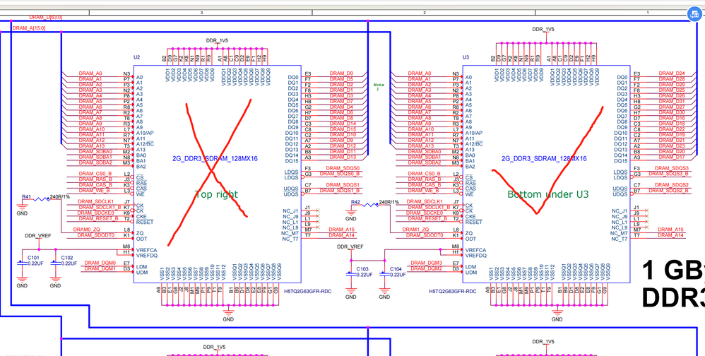

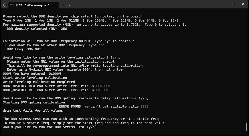

由于某种原因,DDR的data只能从DRAM_D16开始到DRAM_D31
请问怎么用I.MX6DQSDL DDR3 Script Aid V0.10 配置这样子的inc文件

I hope you are doing well
To access the particular DDR block, one needs to use chip select.
Please refer to section 44.4.4.2 Chip select settings from the Reference Manual IMX6DQRM.
Please configure the registers accordingly.
