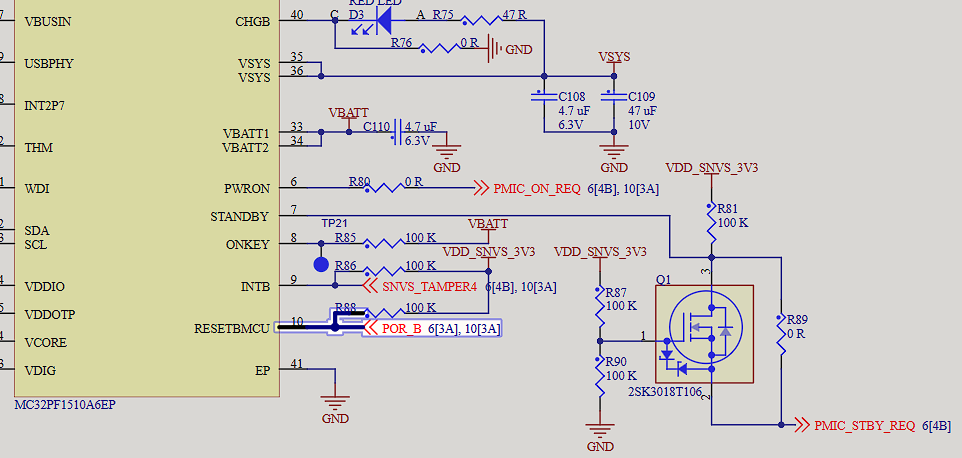

On the hardware we have the PMIC RESETBMCU connected to the Processor POR with a 100K Pull-up to VDD_SNVS_IN rail.
Any pointers to get the software reset working will be very useful.

This could be caused by a hardware connection issue.
Could you please share the PMIC/reset signal section of your schematic?
Best regards.

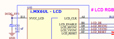

Following is the connection on the PMIC side.

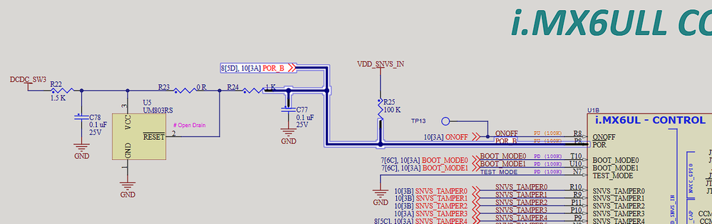

And below is the connection on the processor side.
Pls let me know what needs to be done for the software reset to work.

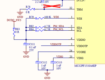

What about WDI input in PMIC? It should be connected through a GPIO pin to soft reset, giving a low pulse to reboot.
This is configured in device tree, here an example.
Best regards.

You mean I have to add the following to the DTS
		pinctrl_wdog: wdoggrp {
			fsl,pins = <
				MX6UL_PAD_LCD_RESET__WDOG1_WDOG_ANY    0x30b0
&wdog1 {
	pinctrl-names = "default";
	pinctrl-0 = <&pinctrl_wdog>;
	fsl,ext-reset-output;
and connect the LCD_RESET to the WDI input of the PMIC?  (we can try this with other GPIOs later, but for now with the above DTS configuration)

When we do what I have mentioned in my last message. The software reboot is working. However, we run into another issue, which is.
After we power off the board and try to power up again it does not power up. Is this because the WDI is pulled up to DCDC_SW3 which in turn is generated by the PMIC? So the PMIC is continuously triggered by the WDI?
Should we instead be pulling WDI up to VDD_SNVS_3V3 ? Do you see any issues with this?

The recommended connection is in page 93 if PMIC's datasheet.
