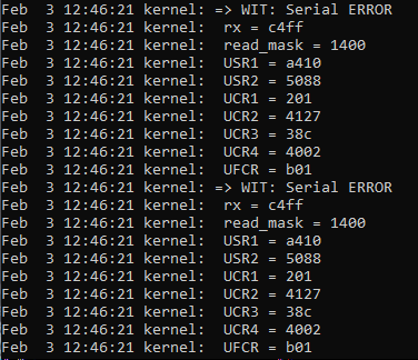

I have a serial communication at 2400 baud 8 Bits parity even of poor quality, and I receive a lot of parity errors. After an undetermined number of parity errors, the processor starts giving without stopping the FF char, with a parity error.
The input hardware signals are at rest. It is as if the receive interrupt flag never returns to 0.
Monitor in function "imx_rxint" of file imx.c

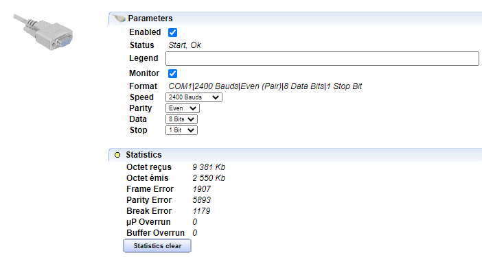

My communication has a lot of parity error but also the reception of break error.
Here is the result of the ioctl command with the parameter "TIOCGICOUNT".
I think µP has a problem under these particular conditions.
Here's the solution I've implemented is one that works. When the number of errors reaches a threshold I do a software reset using the "UCR2_SRST" bit. In the "Part-of_imx.c" file the part of code added.
I have proof that it takes the µP out of this permanent FF sending state in the file "TheProof.txt"
do you think this is the right solution ?

I have made progress on understanding and solving the problem.

jean-françoistr
Hello JamesBone,
Yes, this software solution fixes the problem.
