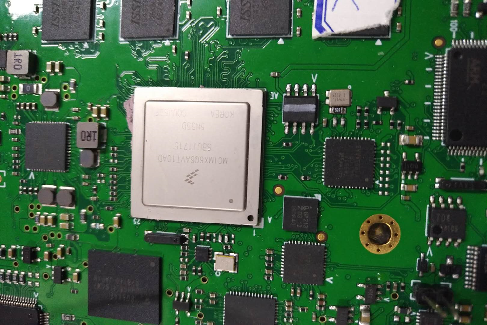

Hi, imx6Q board can't bring up another 2 CPU, can give some good advice?

igorpadykov
Hi jiu
one can try with baremetal test using sdk (please check Chapter 3 Multicore Startup
iMX6_Firmware_Guide.pdf included in package), found on below link
SMP Enable in IMX6
or test with minimal linux image, try use the same image on i.MX6Q Sabre reference board.
May be useful to check number of cores in fuse NUM_CORES described in
Table 5-9. Fusemap Descriptions i.MX6Q Reference Manual
igor

jiujinhong
Hi Igor,
as u-boot print, the cpu is really iMX6Q, and Linux print 4 CPUs, we need FSL advice to fix this issue, please tell solution directly.

igorpadykov
Hi jiu
suggest to run nxp i.mx6q sabre sd reference board with demo images from link:
i.MX Software|NXP
check results, if results are good, replace processor from custom board to reference board
and check again.
igor

jiujinhong
we dont have imx6q reference board, that means FSL can't give any good advice for us?
2,410 Views
igorpadykov
I am afraid there is no way to give defnite answer without running some tests.
You can also try to change part to other, for example from other batch/date code.
2,410 Views

jiujinhong
issue is fixed due to Power.
2,410 Views
jiujinhong
Hi Igor,
I have successfully boot multi-core test in my imx6Q, it run CPU0(Primary) and CPU1 only, can you give some further advice?
