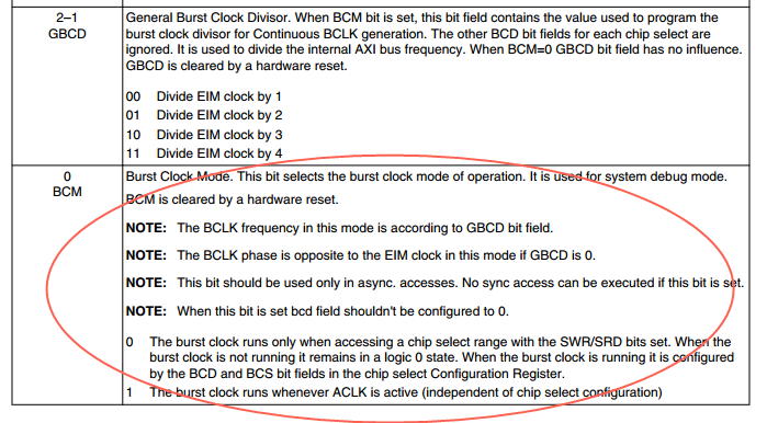

1 The burst clock runs whenever ACLK is active (independent of chip select configuration)
I tried activating the BCLK continuously on my i.MX6Q board by setting ('1') the BCM bit (bit 0) on the EIM_WCR (0x021B_8090h) register.
I am not getting any clock on BLCK - constant '0'.
Did I forget anything?
here is my register configuration
MX6Q_PAD_EIM_BCLK__WEIM_WEIM_BCLK,  //pin_conf
writel(0x00020081, ram_reg);       //EIM_CS0GCR1
writel(0x00000001, ram_reg + 0x90);  // EIM_WCR

  According section 22.5.4 [Burst Clock Divisor (BCD)] of i.MX 6Dual/6Quad Applications Processor Reference Manual, Rev. 4, 09/2017:
“The BCM bit is used mainly for system debug mode. It has no functional use of the EIM in normal mode.” Note, the i.MX6 D/Q does not have special PLL for providing continuous BCLK, synchronized with internal (system bus) ACLK. This feature is supported in i.MX6 S/DL. So, for i.MX6 DQ we cannotguarantee, that BCLK in continuous mode is fully synchronized with ACLK.
