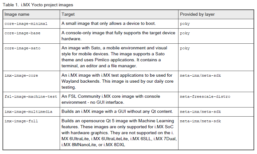

Hello Support Team
- snippet from Yocto project user guide
core-image-base A console-only image that fully supports the target device
hardware.  layer - poky
fsl-image-machine-test An FSL Community i.MX core image with console
environment - no GUI interface.    layer - meta-freescale-distro
-snippet end -
what is the difference between the above two images?
no GUI interface refers, after the bootup, Yocto GUI splash screen won't display and directed to terminal.
kindly confirm

You can see the differences in the following table:
You can choose the ones you needed.
