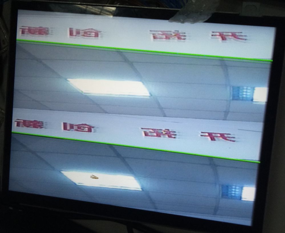

For the PAL input, the output is non-standard by tp2825。
2,366 Views
lianglou
it can't lock vsync
2,366 Views
lianglou
refer to the patch https://community.nxp.com/docs/DOC-330441?commentID=41815#comment-41815 ;
experimental result;
how do  even field and odd field combine?

Rita_Wang
You can refer to the patch https://community.nxp.com/docs/DOC-330441?commentID=41815#comment-41815 .

lianglou
this is implement by IPU_CSI_CLK_MODE_CCIR656_PROGRESSIVE
2,366 Views
lianglou
the output is Y-C Interleaving output mode per 8-bit. field rate is 50Hz.frame rate is 25hz; pclk is 74.25MHz; resolution is 1920X576;pixelformat = V4L2_PIX_FMT_UYVY;
