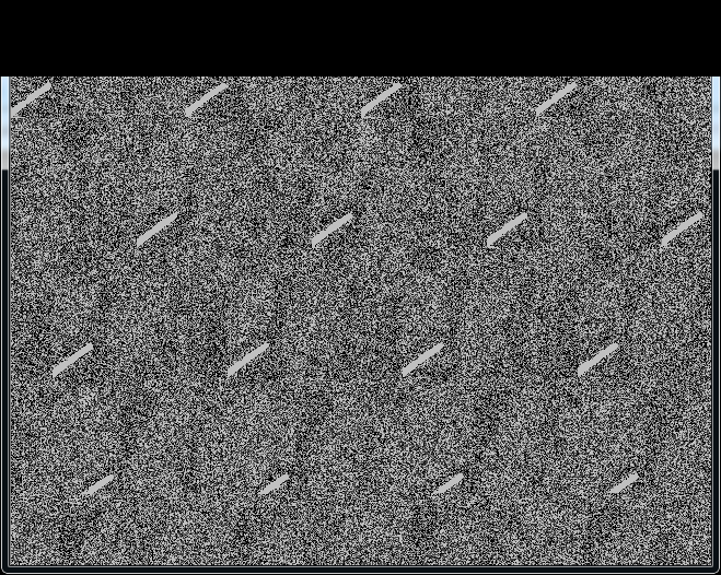

Selea
Senior Contributor I
i followed you patch.
but still I have a strange image captured.
this is the pipe i'm using:
gst-launch mfw_v4lsrc num-buffers=1 device=/dev/video3 ! filesink location=/mnt/nfs/home/sample.raw
the sensor is a 1280x960 greyscale so the capture should be 1228800 bytes.
the raw i have is 1800000 bytes it seems to be as a 4:2:0....
take a look at it, using gimp opening it as raw 1280x960.
8,520 Views
Selea
I'm really diggin iside CSI-IPU- chain.
I can say that there are some missing control and "case"... Mainly it works if the sensor come in as YUV422 and the output from the ipu is YUV420....
any other case (Bayer ...  grey scale... )  are not considered so they are not working proprely.
So i think the CSI ---> IPU ---> chain enned a "serious" patch to include the missing cases.... I think the most common cases could be sensor with Bayer output and greyscale output.
Omar
