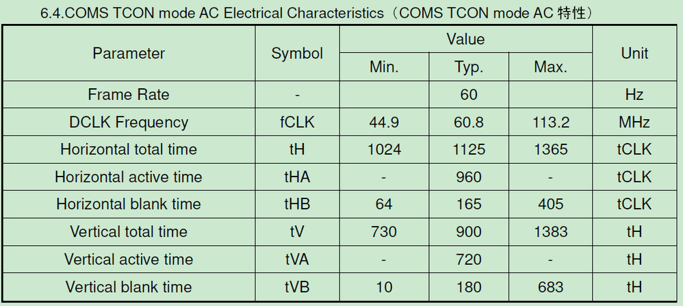

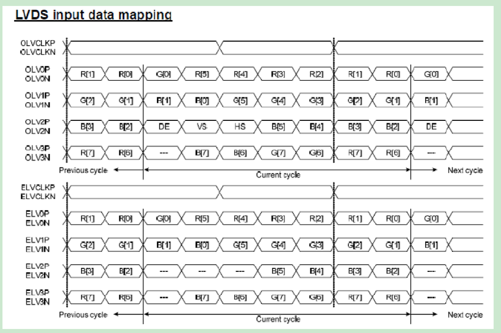

4) the display's COMS TCON mode AC Electrical Characteristics is as follows:
it follows VESA bit mapping.

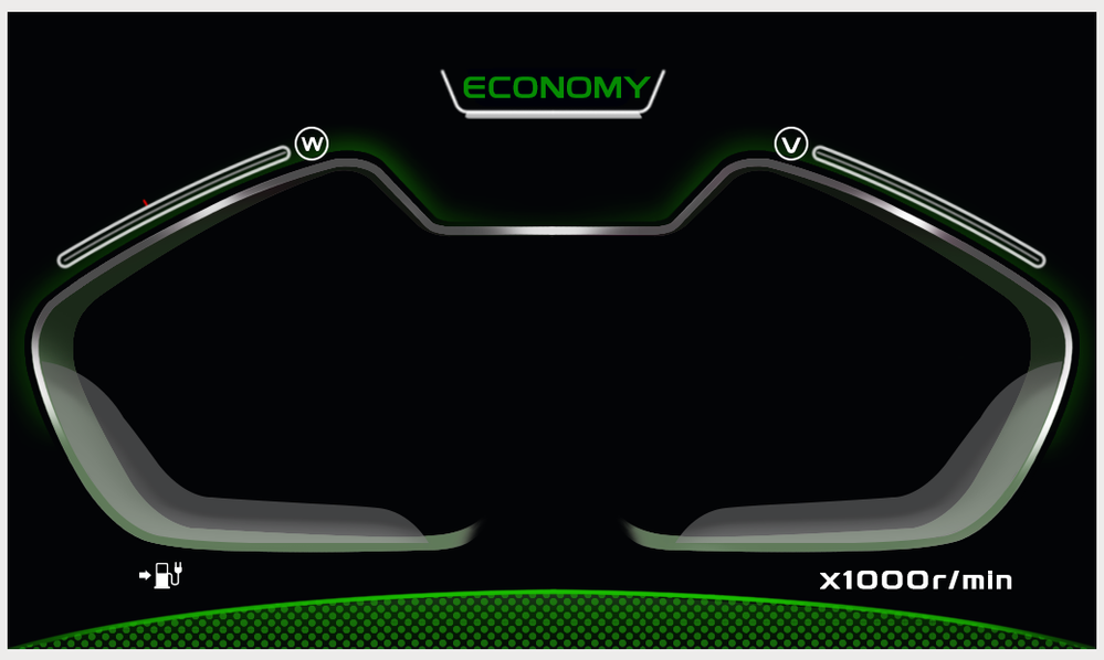

ISSUE:

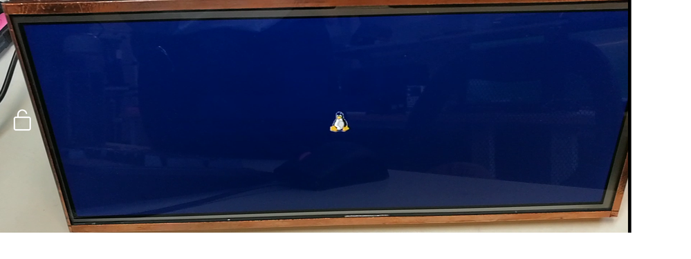

    1: when the kernel boot logo appears, the background color is blue(should be black) and the logo seems abnormal.the picture is as the follows:

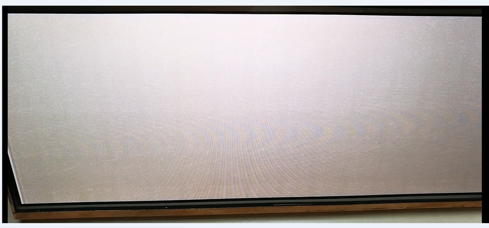

 2: when application run,such as color bars,the white field picture has  snowflake(雪花状) 。
and the color bars picture as follows,the top is black bar(but only blue color),the bottom is white bar(with snowflake).
