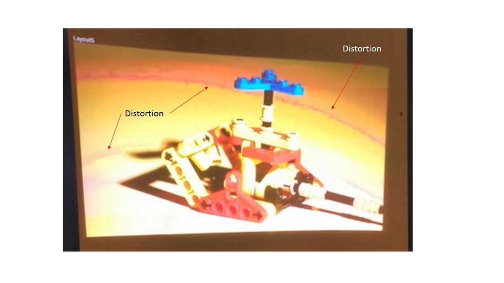

I'm developing a product with imx6 sabre sd board with android Jelly bean 4.3. The main issue that I need to solve is about using the HDMI. I'm successfully develop an app to show different contents in the local lcd and in the hdmi, but if I try to show  a video throug the hdmi the output show some distortions (see picture). I investigate the parameter bits_per_pixel, and the value used is 16, i tried use other values to this parameter but without success, any suggestion of how to fix it? The same video running on local lcd don't show the same problems.

Hi Juliano
one can try Demo Images from link
i.MX 6 Series Software and Development Tool|NXP
also try to change hdmi monitor and use quality hdmi cable
with good shielding.
