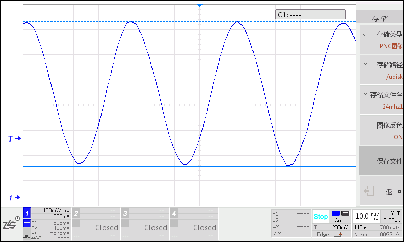

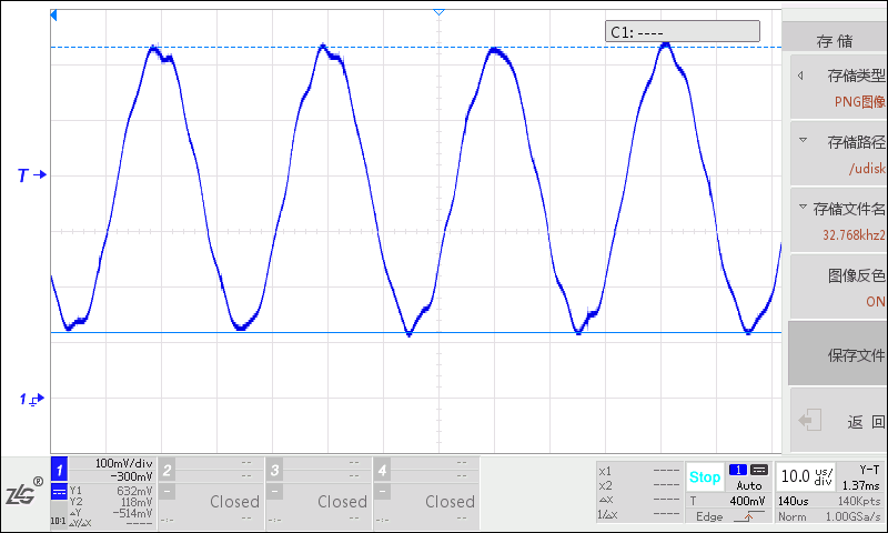

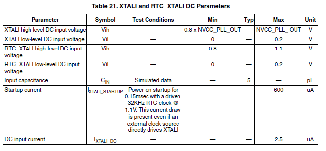

Hi,igorpadykov:
     I have try to measure the imx6 32.768khz clock and 24MHZ wave.The Vp-p seems not  conforming to the requirements.meet to the picture.
24MHZ:
32.768KHZ:
the  requirement is below.

igorpadykov
Hi CAI
one can check clock guidelines provided in i.MX6 System Development User’s Guide
https://www.nxp.com/docs/en/user-guide/IMX6DQ6SDLHDG.pdf
igor
