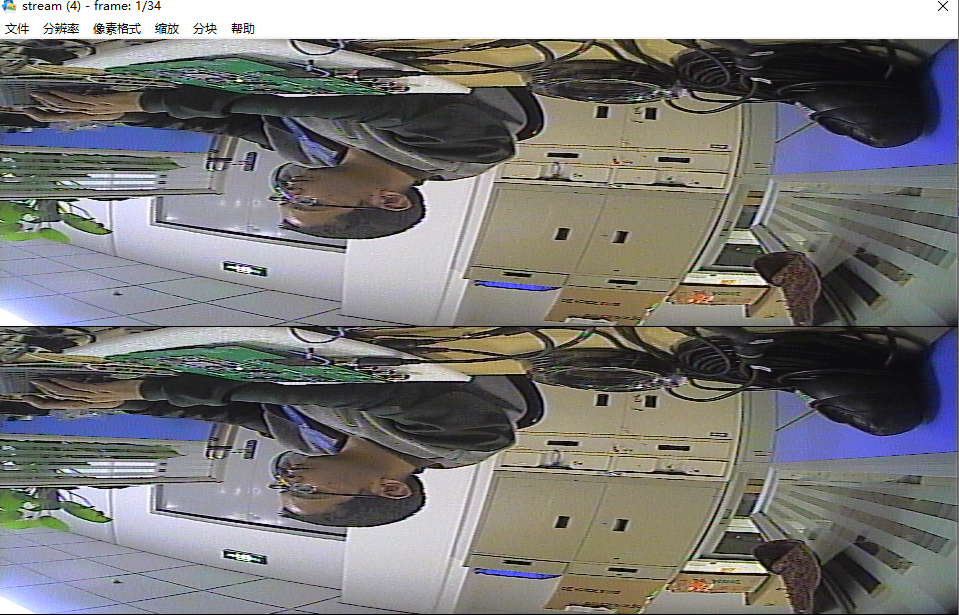

1.bsp linux 4.1.15
2.camera IC  tp2854

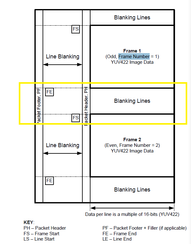

3.input D1 camera data fromat , Frame Start/End sent at each field VBLANK
4.imx6 capture yuv422 data is , and  fps is 12.5fps
5.iMX6DQ TP2854 MIPI CSI2 720P HD-TVI camera surround view solution for Linux BSP
