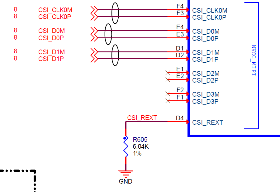

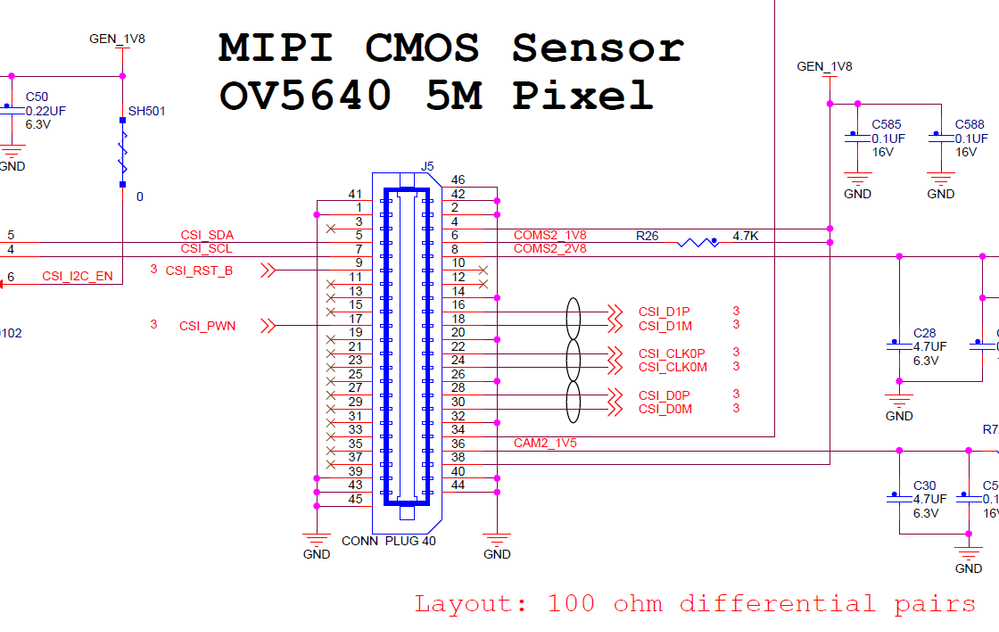

I have some question about mipi csi terminal resistor .
In imx6 SDB schematic, there isn't any terminal resistor in MIPI CSI port,same as imx8qm VALIDATION CPU CARD. Does not need these terminal resistores or already integrated in SOC?
Thank!

yes terminal resistores are already integrated in SOC.

   These resistores need be enabled / disabled by SW or always active?
Thanks!
3,045 Views
igorpadykov
they are always active
