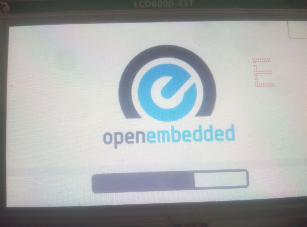

analogicstechin
Thanks For the Immediate response,
Already we are modified the ppm file , but need to modify in progress  bar open embedded logo,please find the attachment for clear understand.

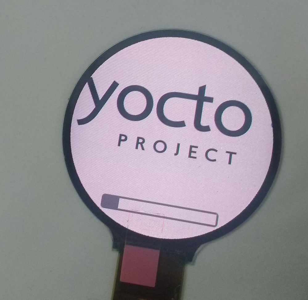

nandishguruling
Hi  Edward,
Thank you for your quick reply, yes i commented in matchbox/session, i am bale to see the my qt apps directly by the following scenario (when i power on the board blank screen->qt apps) but my requirement is while booting time instead of penguin image i displayed the my-company logo is done, after that yocto progress bar is coming instead of this progress bar i want to display my logo please find the below image, if any solution please share it here,
thanks in advance,
Nandish S.G

nandishguruling
Hi Edward,
Thank you for your response,  i don't want to disable the logo i want to change the above progress logo i.e yocto project image instead of that image i want place the my own image, any idea how to do, please share it here and your help would be appreciated,
Thanks in advance,
Best Regards
Nandish S.G
3,480 Views
edwardtyrrell
Senior Contributor I
From what I remember in my kernelconfig you could actually set the path for the icon ( if required ). If all else fails menuconfig should state the name of the icon and you might be able to do a system wide file search and replace it as a test - with same name obviously. Once located you can do it properly using the layer/recipe way.
Ed.
