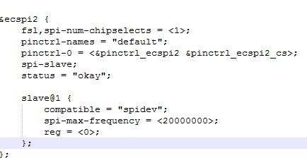

HI:
I use imx6ul  ,linux kenerl version branch imx_4.1.15_1.0.0_ga, I refrence branch imx_4.14.98_2.0.0_ga add spi slave mode to imx_4.1.15_1.0.0_ga, and spi slave mode is proper functioning, but it affects ecspi flash and other pad ,such as PAD_GPIO1_IO00,details are as follows:
1 . ecspi flash problem:
my ecspi flash config
   &ecspi1 {
    fsl,spi-num-chipselects = <1>;
    cs-gpios = <&gpio4 26 0>;
    pinctrl-names = "default";
    pinctrl-0 = <&pinctrl_ecspi1 &pinctrl_ecspi1_cs>;
    status = "okay"; /* pin conflict with WEIM NOR */
    flash: m25p80@0 {
        #address-cells = <1>;
        #size-cells = <1>;
        compatible = "micron,n25q128a13";
        spi-max-frequency = <40000000>;
        reg = <0>;
        pinctrl_ecspi1: ecspi1grp {
            fsl,pins = <
                MX6UL_PAD_CSI_DATA04__ECSPI1_SCLK     0x1b0b0
                MX6UL_PAD_CSI_DATA06__ECSPI1_MOSI     0x1b0b0
                MX6UL_PAD_CSI_DATA07__ECSPI1_MISO    0x1b0b0
        pinctrl_ecspi1_cs: ecspi1cs {
            fsl,pins = <
                MX6UL_PAD_CSI_DATA05__GPIO4_IO26     0x1b0b0
and ecspi3 slave config
&ecspi3 {
    #size-cells = <0>;
    pinctrl-0 = <&pinctrl_ecspi3>;
    status = "okay";
    spi-slave;
    spidev0: spi@0 {
        reg = <0>;
        compatible = "rohm,dh2228fv";
        spi-max-frequency = <20000000>;
        pinctrl_ecspi3: ecspi3grp {
            fsl,pins = <
                MX6UL_PAD_NAND_CE0_B__ECSPI3_SCLK    0x5011    //0x70a1
                MX6UL_PAD_NAND_CE1_B__ECSPI3_MOSI    0x5011    //0x70a1
                MX6UL_PAD_NAND_CLE__ECSPI3_MISO     0x5011    //0x70a1
                MX6UL_PAD_NAND_RE_B__ECSPI3_SS2        0x5011    //0x70a1
            SS>;

spi_imx 2008000.ecspi: probed
spi_slave spi2: /soc/aips-bus@02000000/spba-bus@02000000/ecspi@02010000/spi@0 is not called 'slave'
spi_slave spi2: Failed to create SPI device for /soc/aips-bus@02000000/spba-bus@02000000/ecspi@02010000/spi@0

spi_master spi0: I/O Error in DMA RX
spi_master spi0: failed to transfer one message from queue
mount: mounting /dev/mtdblock6 on /home/config/ failed: Input/output error
Please press Enter to activate this console. random: nonblocking pool is initialized
root@root:/#
2.then I use spi_slave
root@root:/# echo spidev > /sys/class/spi_slave/spi2/slave
i use  MX6UL_PAD_GPIO1_IO00 as GPIO input, is pulled to high level.
                        MX6UL_PAD_GPIO1_IO00__GPIO1_IO00       0x17059 //0xb0 //0x000010B0
Labels (5)
8 Replies
4,149 Views
lixuhui112
and I use imx_4.14.98_2.0.0_ga kernel is the same phenomenon

&ecspi2 {
pinctrl-0 = <&pinctrl_ecspi2>;
spi-slave;
status = "okay";
spidev@1 {
compatible = "spidev";
reg = <0>;
Kernel的引导log如下:
spi_slave spi1: /soc/aips-bus@2000000/spba-bus@2000000/ecspi@200c000/spidev@1 is not called 'slave'
spi_slave spi1: Failed to create SPI device for /soc/aips-bus@2000000/spba-bus@2000000/ecspi@200c000/spidev@1
spi_imx 200c000.ecspi: probed
如果我注释掉
spidev@1 {
reg = <0>;
这几行,则不会报错。但是,dev目录下依旧没有spidev节点出来。另外两个master设备能够正常在dev中显示。
所以,我现在的问题是,如何使能SPI-SLAVE,并且在dev中显示slave节点?以便我用户空间的程序调用来接收数据?

guochgz
dev下没有接口的问题搞定了,修改dt文件,改name为slave就好。

guochgz
但是现在还有一个问题,通过spidev设备节点,读到的Master发送过来的数据不对,全是0x0。这个可能是什么问题? 是不是slave模式没有正确启动? 需要pastedImage_1.png
在这个目录下执行什么操作吗?

jimmychan
what is the connection of the SPI on your board?
what is the pins mux setting in the dt file?
4,149 Views
guochgz
   前端接了一个CC1200 RF 收发芯片。
   PIN管脚如下所示,其中CS管脚是我们自己接的一个GPIO。会按照我们程序读取数据的逻辑,拉高拉低。
4,148 Views
jimmychan
please add  cs-gpios = <&gpio4 22 0>;
