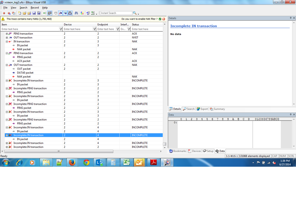

We are operating iMX6 USB OTG port in device mode. We are able to connect the host device and start the transfer.
But after few seconds of working, imx6 USB OTG port is not responding to IN packet sent by Host device.
Based on our understanding, USB device controller should send atleast the NAK packet for the IN token from the Host?
Are there any known issues in imx6? Could you please advise on how to debug this issue further?
Are there any test daemons available to check the USB transfer between PC and imx6 USB device?

Thanks for your comments. Please note that this issue is not happening in the standalone setup.
We could re-produce this issue only when the Graphics/GUI engine is running in parallel.
Problem:
Imx6 USB OTG port is configured in device mode.  We are able to connect the USB Host device and do the data transfer.
But after few packets data transfer, imx6 USB device controller is not responding to  PING and IN token sent by Host device.
Refer the attached snapshot for the details.  As per our understanding , responding to IN token is done the USB core in the HW and not in the SW.
What we need from freescale:
  1. List of all Possible root causes for this issue
  2. Are there any known workarounds/fixes for the above problem? (or) Any other inputs to further debug this issue?
  3. Need test utility to verify the data transfer when the imx6 USB OTG port is operating in device mode.

karthigeyannata
Thanks for the feedback.  Are you referring to check USB VBus power line or Power lines to imx6 ?
We have reduced the CPU clock to 400mhz , but still the same issue occurs.
Need few clarifications:
1.You have mentioned the problem is due to DDR /Power supplies. Could you please help us on how you are correlating the above mentioned USB controller behavior with DDR/Power supplies?
2.As mentioned in the above logs , the imx6 USB OTG controller is not reponding to IN and PING packets. As per our understanding, this is supposed to be done by the HW USB core itself and not by the USB SW driver ? Is it correct?

karthigeyannata
We have done requested tests
-There is no problem with Power
-There is no problem with DDR
-There is no problem with Apple device since the functionality works when we reduce the graphics processing which uses GPU/IPU drivers.
During the normal condition, Are there a possibility that imx6 not responding to IN & PING packet when the imx6 device operating in device mode?
This issue is pending for long time. Could you please support us for the next steps?
