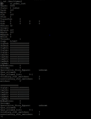

I am porting my I.MX6 platform kernel from 4.9.11 to 5.4.24, and face some weird issue on the UART port
after i port the code and my device tree, I manage to boot up my machine. Then I tried to read some data from another subcpu which is connected to ttymxc2.
In console, I tried to cat /dev/ttymxc2, but it returns me with some text that seems like system related information as below:

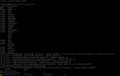

I tried to do a stty then cat, it returns me with another type of information, which seems to be like cat /proc/filesystems plus something else as below:
I cannot understand why is this happening. It seems like the ttymxc device is mixed up with /proc/ information. Can anybody advise?
One thing is that the system is working fine in kernel 4.9.11. Only change is changing the kernel from 4.9.11 to 5.4.24.
By the way, i am using same bootloader 2017.03 for both the 4.9.11 and 5.4.24 kernel. I suppose 5.4.24 kernel can work well with 2017.03 uboot?

igorpadykov
Hi Tee
you are right, reason may be in uboot, recommended to use
uboot version (v2020.04) as listed in Release Notes of each BSP described on
https://www.nxp.com/design/software/embedded-software/i-mx-software/embedded-linux-for-i-mx-applicat...
https://source.codeaurora.org/external/imx/uboot-imx/tree/?h=imx_v2020.04_5.4.24_2.1.0
igor

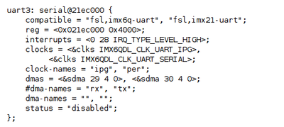

zc_tee
Hi Igor,
After doing some searching online, i tried to disable the serial port dma in device tree
Then my machine's UART port works.
I think i will disable the UART dma for now and test further. Do you forsee any issue disabling the UART's dma?
Tee

zc_tee
Hi Igor
Thank you. I will proceed with disabling UART dma.
