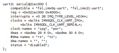

In my project  ttymxc2 is used to communicate at 2000000 baudrate to external device.
In kernel 4.9 it was working fine but when we ported to 5.4 it started giving issue.
After doing some searching online, i tried to disable the serial port dma in device tree
Then my machine's UART port started working on kernel 5.4
I am not understanding
why by removing the dma it starts working?
How to make it work with the DMA enabled?
Thank you
Chandrajeet.
