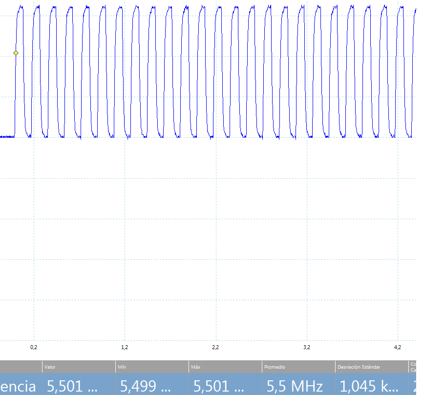

I've tested 5.5Mhz in kernel space (3.0.5) using memory mapped + pointers (writel/readl is 100% slower): would be possible to improve this frequency using inline assembler?. Is there any example of inline assembler handling GPIOs?

EgleTeam
Contributor V
Hi Anson,
What do you mean with "stable"? All the time?. If do: that's not possible. With a "regular" linux  100% not possible. Using a RTOS (i.e.: Xenomai) you can get a "relatively" stable throughput but of course not 5.5mbps/gpio. What I meant is we got toggle a GPIO at 5.5Mhz measured with an oscilloscope.

ZeeFrench
Nice programming and record, I was only able to toggle it at 3.6 MHz ! You can otpmize a few cycles @ 1 GHz but at one point there is a limit due to the fact we have to go through caches, a couple of crossbars and a peripheral bridge @ 66 MHz. The trick to reproduce it with platform SDK (and QNX, they should be aware of this) was to enable caches, MMU and configure mmu entry for those as a standard entry and not as strongly ordered as it is by default, it allows the accesses to be buffered :
+ mmu_enable();
+ // Enable L2 Cache
+ _l2c310_cache_setup();
+ _l2c310_cache_invalidate();
+ _l2c310_cache_enable();
- mmu_map_l1_range(0x00a00000, 0x00a00000, 0x0f600000, kStronglyOrdered,kShareable, kRWAccess); // More peripherals
+ mmu_map_l1_range(0x00a00000, 0x00a00000, 0x0f600000, kDevice, kShareable, kRWAccess); // More peripherals
